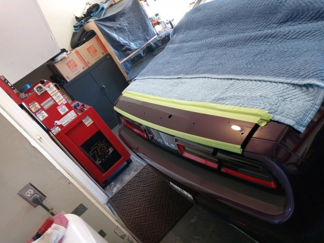

Do NOT scratch the new Car..........
Near New take off spoiler $150 plus actual shipping FedEx Ground.
UPDATE: SOLD on FB.

Fill the holes and leave it like that!
There are a few of the Stock Demon record hunters running no spoiler. Looks goofy to me. I already installed the SRT Performance Spoiler, so too late. I am not going through that again any time soon.
Also I have no issues with the camera function after the install. If anything it's a wider angle. You can see the bumper and still see plenty of sky so not sure what the issue is with some people.

Thread Starter #292
Been thinking about making that change. Any pointers?
#1 you have to remove the carpet on the underside of the trunk lid. So just do it. #2 you have to pull up and keep substantial tension on the spoiler to release the plastic Christmas tree/truss clips (4). I stuffed folded terry cloth washrags under the spoiler. To release them I used a long screw driver levered into the access holes to pop each side. If there is enough tension you distinctly hear each pop. One person I saw used long needle nose pliers but they must be VERY long. One other person I saw just cut them. But I plan on selling the spoiler so I preserved them to make it easier for the buyer. To release the adhesive I carefully used a flat blade screwdriver. These adhesives release as they are stretched parallel to the paint surface. So if you can imagine I plunged into the adhesive near the paint surface about 1000 times and slowly but surely the release was complete.
I would also plan on gutting the trunk and getting inside. I use a milk crate to step on and climb inside. At one point I was sitting on the Battery with my feet in the spare tire well.
Do NOT do this if you might be having a bad day or if you do not have plenty of time. I think it took me about 2 hours.
