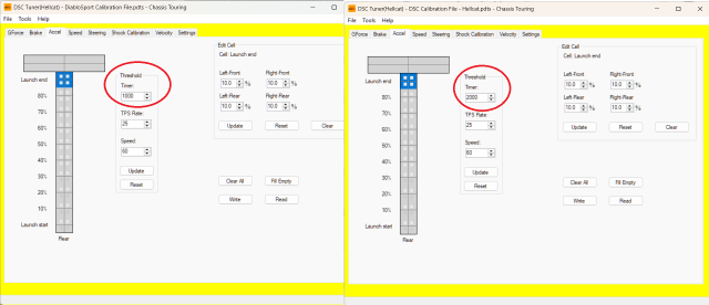

Noticed that my timer is set to 1000 now on the new version of the dsc

If I remember right, ds only changed the timer. All the other settings were the same. I have mine set with a ton of pressure on the rear at launch and the front end to come up. This has stopped any spinning I have had. Ill look into a free site to upload the files.

Diablosport: Accel Threshold Timer: 1000
DSC: Accel Threshold Timer: 2000
When I talked with Mike at DSC several years ago, 1500 seems to be the sweet spot.
Mike has industry knowledge as well but I'll leave it at that.
Jeremy and Collin were great too.
Everything else that can be seen/edited with the DSC Tuner Software is the same between both tunes.

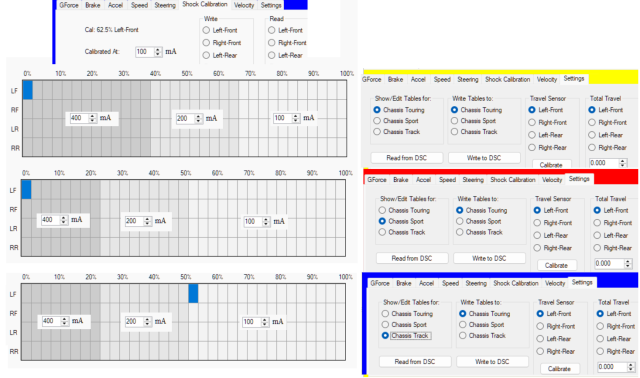

The bottom graphic highlights Touring, Sport and Track Chassis.
Where DSC differs from OEM is the ability to fine tune each shock independently.
Mike explained the OEM Hellcat suspension has 3 settings which are represented by 400, 200 and 100 mA in the shock calibration tab.
Also notice how GForce comfort parameters change from 34 (Touring), 18 (Sport), and 28 (Track) in the GForce tab.
Out of the box, the DSC tune is pretty good. I do think DiabloSport had acceleration figured out.
