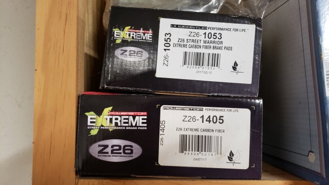

Z26 here. Front and rear. Pretty much zero dust.
Could you be more specific with a part number?
Oh sorry it’s been a while. I could look it up for you though. Thought you were asking what brand.

Part #s-
