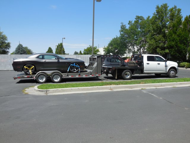

A 20-footer is enough, if using wheel nets and idlers so the tie down ratchets only have to come past the car by a foot or so. Of course, that requires E or L track spaced correctly for the track width.

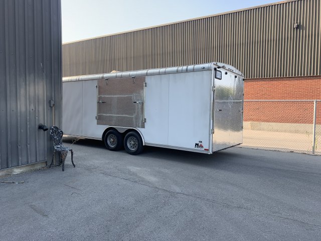

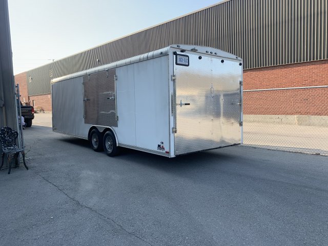

Is that a 26’? Look forward to seeing it finished.

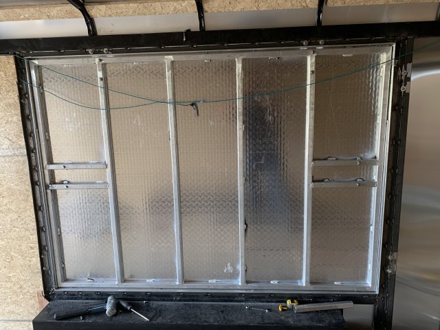

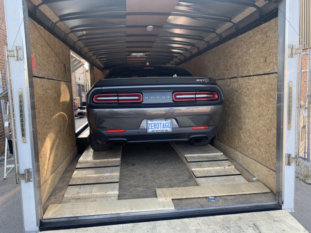

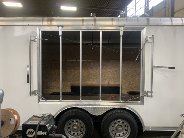

24 foot....I think.:unsure: It is almost done. I will be checker playing the whole interior. I will post my build thread when I’m done.

I was wondering about door clearance...until I saw the last photo. Elegant solution.
27,250
I will be wrapping the whole floor in chrome checker plate so the wood I screwed down will be hidden. I am also going to do the walls in chrome checker plate. I have all the material in stock. I just have to find some time after work to finish up the trailer. Also by raising the car it makes it easier to strap it down.
6,760
12,593
Just don't make it too slippery. Wood is pretty good at providing traction (when dry).
What are you doing for tie downs?
27,250
I was also thinking about the traction. If the checker plate is too slippery then I will just put some industrial grip tape just where the tires roll. I am not sure yet. I have never modified a trailer before so I am learning as I go.
I just use regular all purpose heavy duty tie downs nothing fancy.

I'm a firm believer in using wheel nets, and very anti tying to sprung parts. That basically means E-track under the tires.
Having tied down all kinds of vehicles over the years, a Challenger presents different challenges than what I'm used to, with the low clearance in the front, especially.

Can't use wheel nets because the wood is just screwed down on top of the plywood floor. I would have to take all the wood off and secure the first piece of wood to the frame.
6,760
12,593
I think you could. If you're only setting it up for the 'Cat, then you could install two D-rings per wheel in the appropriate spots. Either in front of and behind the tire, or the same but just outside the sidewall, depending on the type of wheel net.
I ran into the what-do-I-secure-the-E-track-to? issue on my trailer, since the aluminum flooring is really only tack welded to the cross members.
Luckily, the I-beam cross members at 12 inches on center allowed me to use bolts there, then I riveted the rest, essentially making the flooring profile and E-track one.
In your case, I'd go down to the cross members, adding backing plates as needed, using quality fasteners. McMasterCarr has them in almost any length.
