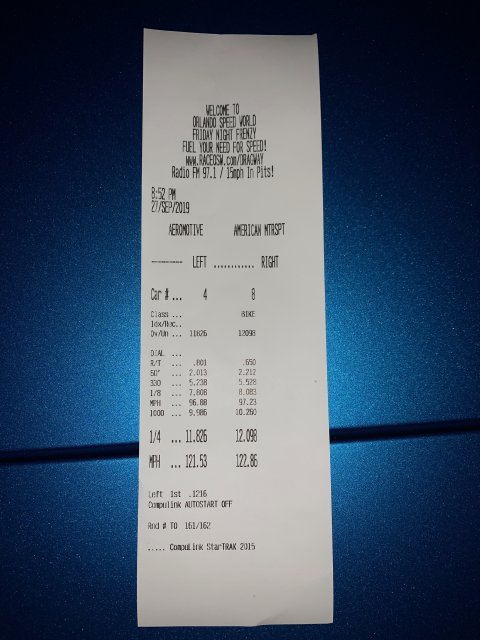

After 3 not so great passes for me, and the Redeye getting better with every pass, we went out for the final time and actually had a drag race. When I released the brake, I don't know where he was because I was focused, but near the end I could see him next to me, and gaining. This was by far the best pass for me that night.

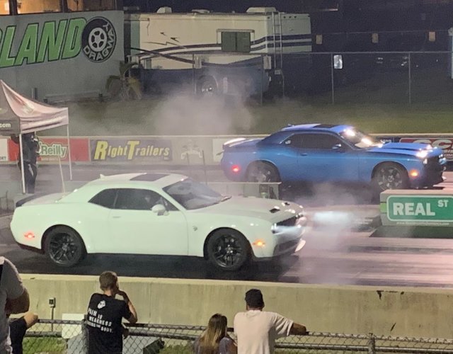

Best picture of the night.

Nice job , glad you had fun , that's what it's all about !
The more you go the faster you'll get.
If your on stock tires ?.... some DR's will help a lot.

Thanks! I have DR's, 305, 555R's on 11" wheel from PKAD. The car has a DIRS, the wheels and tires and a catch can. Otherwise stock.

Looks good! I guess you realize your 60’ time needs a little work. With DR’s your 60’ should be from the low 1.7 down to mid 1.5 range. That will greatly reduce your ET. It just takes practice but finding the right tire pressure, a good burnout and staging properly will help you get the best times out of your car. Have fun!

With some practice I hope to be able to do a good burnout, definitely stage properly, and leave correctly. The car was great! The driver needs work.

First time out, not bad.

I'm not knocking the 555R their good DR's but the M/T SS or R will do ya a little better at the track , I have found that 26psi is a good spot on good track prep.

Thanks, Mean Cat. I'll start at 26psi next time. I was wondering what pressure would be good. I was at 29psi. Also great advice on the tires.

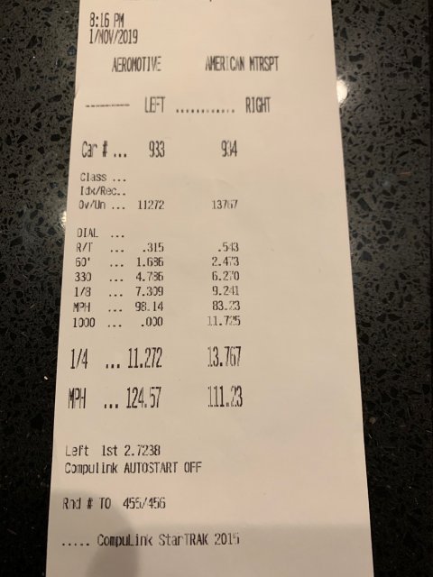

Went back to the track and did much better! On this pass, I was lined up with my son in his 2018 Mustang GT. It was his worst pass of the night, my best one. I must have intimidated him.

(y)60’ time made the difference!

Good to see more people getting these cars to the track where you can actually use the power. You're learning a good ET is all in the 60'. Those Nitto 555R tires will settle in around a 1.6x 60 in my experience. They're what I use on the street. For the track I'd get a set of 17x10 wheels with some Mickey Thompson ET Street R tires. I run a 305/45R17 and can get mid 1.4x to low 1.5x 60 foots. If yours is a wide body you may check on a 315 size.
