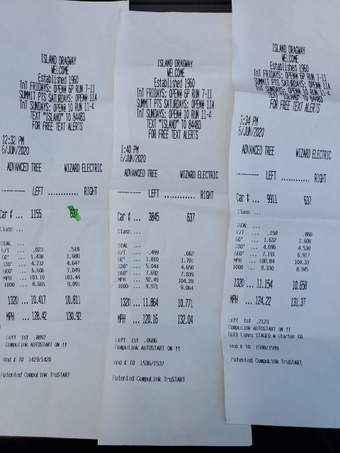

First time out with the Hellcat
5,190
17,454
I am finally able to log my runs now that I have a windows tablet in the car. I only could read 1 of my previous logs directly from my Diablo. I haven't got a clue why that one worked and all the others gave me an error.
So this year I have been logging. Still trying to figure out what pids to log.
