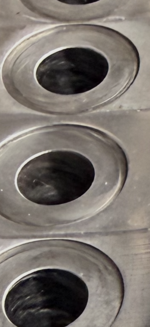

Are you pointing out that it failed because of a lack of chamfer on bolt holes? I see no witness marks from the stud and washer on that bolt hole.
3,819
9,044
Thread Starter #22
No, but why does the surface were the hardened stud washer sat have such a pronounced indentation from the washer? This is a 4140 material billet cap, they’re not soft. How did just torquing the nuts down on the washers do this? Aren’t the washers there to kind of spread the nuts load bearing surface out a bit more and provide a nice smooth hard surface for the nut to spin against and not dig into the cap?
Agreed that 4140 is a very tough material, I machine parts out of it all the time. It takes a lot of pressure to indent the flat bolt surface.
Was the 8740 not heat treated correctly?

8740 just did not have the tinsel strength to make enough clamp load so they started to stretch and start acting like springs. More of them, like 4 studs per cap would have spread the load across more fasteners or the use of larger diameter studs but unfortunately the use of both those methods in a standard BGE Gen 3 block probably then starts to weaken the block. The answer short of a better aftermarket 4 bolt block round gave been to use a better grade fastener, a tool steel stud. Just lime arp 8740 head studs, after 25 psi of boost I was lifting heads and getting combustion gas into the coolant, replaced the 8740 studs with a torque value of 110 ft lbs with 625 studs with a torque value of 150 ft lbs and no more combustion gas into the coolant! There tinsel strength exceeded the force of head up lift and kept the joint clamped. Unfortunately arp does not offer 625 main studs but they need too!! There are companies out there that offer them but their like 3-4x the cost of regular arp studs, no difference from how regular rods bolts are x price, arp 2000 2-3x price, and 625 5x price lol, you get what you pay for no doubt! I would prefer 625 over all other tool steels because it is not susceptible to hydrogen embrittlement like so many other tool steel fasteners are. You know you can ruin some, if not all non 625 tool steel studs by just touching them with bare hands? And cleaning them with brake cleaner can ruin them period??? Yes, they can! But not 625, it’s the greatest thing since sliced bread in a high tensile strength fastener that sees repetitive load unload cycles like main and rod bolts see, especially rod bolts.
I hope this has been entertaining and enlightening too many for the time I’ve spent on this form and the other, making a post on this very important topic of and stud, material differences, and why they are so important and what to look for in this assemblies and failures to know you have to do something better or not on rebuild.

This surface is definitely part of the puzzle, it did not look like that when first assembled. They all looked like cap Number one. Why did it end up looking like that?
I assumed (ass of you and me) that the bolt hole was counter bored for the washer seat.

I assumed the caps were counterbored as well, squishing a washer into the cap is not a great idea.
Are you telling me those main studs aren’t rated for 1500-2000hp? My investigation lead me to believe that they were, but I don’t know anything from personal experience.
625 is also a hot topic with Steve Morris these days as it relates to their resistance to hydrogen induced delayed fracture. Since your studs were very much intact, I didn’t think about the material.
A big NO! Standard 8740 ARP studs are really not much stronger than the stock bolts, really! And as proven in this build not good for 1500 let alone 2k to the tire! Not in pairs at least! Studs are like for a few reasons, they are usually not torque to yield, they are reusable (to an extent, how do you know if they yielded in use??) and generally provide a better clamp load because of the way a nut works on the stub verses threads down a hole but unless they are of a better material they are usually not much stronger then most factory torque to yield true not knock off OEM Torque to yield high grade fasteners are. 625 is good stuff, there are some build shops using what they say are the same as 625 material, bring sold as 625 material, but not stamped ARP 625 material and I highly doubt truly is 625 material. It’s sad when you really really can’t trust what you get in the same boxes any more, what’s real and what isn’t???
Holes where countered bored for the washers and nuts, the indentations I was referring to are inside that counterbored area, the witness marks can be seen best in pictures in post 1. Here is a close up of that original photo.

Having machined 4140, I am surprised that the washer dug into it. I can see the studs stretching. better bolts, yeah might help. but at what point do you pull the threads in the block? most bolts will stretch! the torque value is supposed to stretch the bolt the recommended value set by the MFG to deal with what load it will see. A bolt that will not stretch I question if it would stay tight either.
