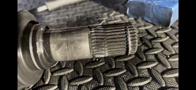

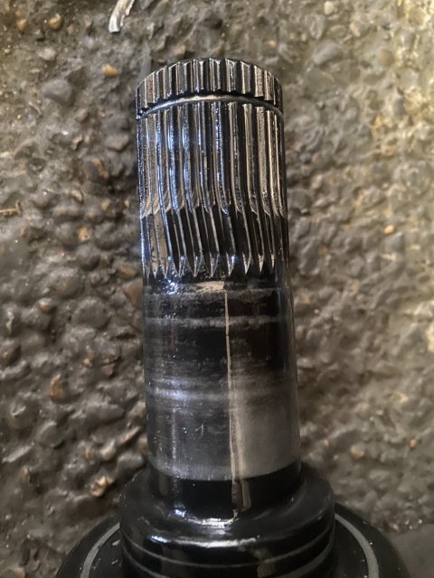

Here’s your first stubs that were twisting in a stock rear after only 3-4 passes. GForce replaced them for you for $300 each if I remember correctly?
They replaced mine completely with a new set because the stubs were undersize and wobbled in the Diff. The splines showed signs of wear and they didn’t even have 1000 miles on them. I think their having quality issues from their supplier, these things should not be twisting like they are.
I’m not impressed with them for the price. If I could get my money back I would and try the new DSS solid ones. I know a guy that was in DSS test group beating on them for over a year now running 5.6 in the 1/8 1.2 60 fts and they are holding up perfect so far.
View attachment 96105 View attachment 96106
Even though these stub shafts show some twist, there does appear to be a bit more engagement of the spline length with the OEM diff then with the Wavetrac. Back in the day, 70's-80's, when we were using axles made by Mark Williams, Summers or Strange, a certain amount of twist was something very normal and expected and still would not break. We just continued using them. If they reached an amount of twist that was beyond the manufacturers allowance, then we were told by that spec to replace them. This happened to all axles and our power level wasn't even as high as what we are getting out of our engines now. We were always removing the axles back then and checking them for twist. We even used to make a straight paint mark along the entire length when we first installed them to be able to monitor them over time. Keep in mind that you can allow more twist on a long shaft used in a live axle vs a short stub shaft used in a IRS so the allowable twist will be less. This might be something that we will have to consider and keep an eye on, no matter how strong the manufactures make them. Maybe they should start looking at gun drilling them like they are doing to the live axles today. Tube is not only stronger, (more resistent to permanent twist), but also snaps back to it's original shape better then solid does, and is lighter.

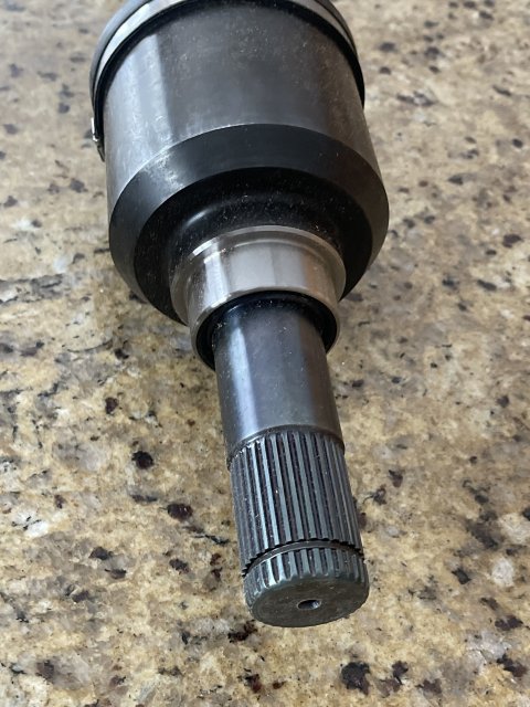

#96
@hellno saw the carnage on IG, lets compare notes, heres mine!

#98
Yep that’s the problem,and they will say the axle wasn’t fully engaged
4,385
10,911
#99
Maybe they need to work on fitment of their axle so it is fully engaged
17,577
55,026
The interesting thing about that statement is that the cross-sectional area doesn't change between the area that twisted and what would be the "fully engaged" position.
(i.e., the shear stress doesn't decrease in a notable way, at least not until you get to a much closer area towards the tip)
