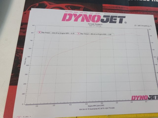

dude, you need to do a compression test, leak down test, pull plugs and check them. What kind of dyno was it? Dynojet? Mustang? We’re the numbers corrected? Dyno numbers are objective

Dynojet.

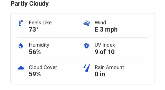

Ok, what were the weather conditions? Was that the corrected or uncorrected?

Corrected. Car wasnt hot. 30 mins cooldown between pulls. 3 pulls. Never had it dynoed before. 1500 ft elevation

Attatched is log from a dyno pull and my dyno sheet

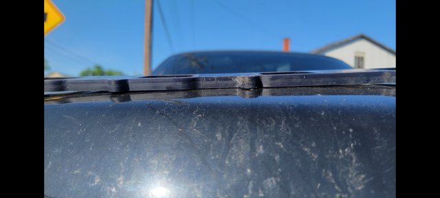

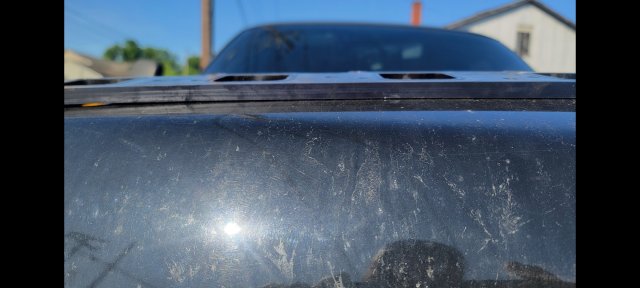

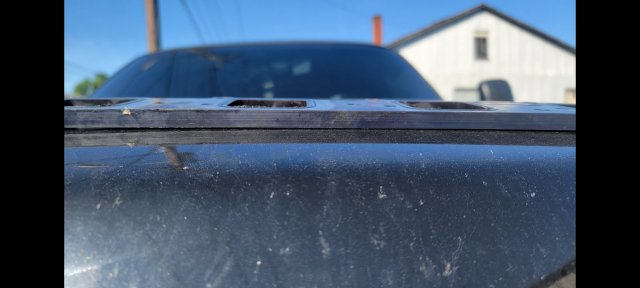

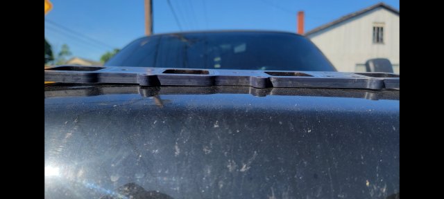

The o rings made into the spacer are extremely flat t. I dont recall them being this flat.
@16GoManGoHC2 knows of some replacement o rings he could get you the part numbers

Inspecting and cleaning spacers and orings. None are broke or cut

I took a look at the log. I don't think there's anything wrong. My opinion is that 2.5 pulley is just not efficient and it's over spinning the blower. Your car made 832rwhp at 1667 mg of aircharge on E85 with 20deg of timing.
My car made 787rwhp at 1611 mg aircharge on 10deg of timing on 93. That was with a 2.72 pulley. Each degree of timing is worth 10 to 11hp give or take so you're right in line with what I'd expect based on the aircharge and blower efficiency characteristics.
I'd go do a 2.72 - 2.75 pulley and live happily ever after (and make the same power) or upgrade to a larger supercharger if you just have to have more. It's either that or start chasing ways to free up the supercharger with a ported inlet, bigger tb, etc but then you're still out of the efficiency range really.
