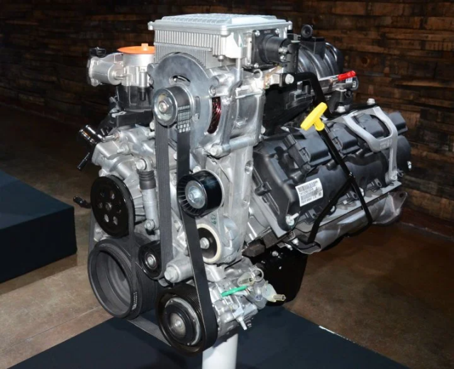

It's a chunky looking electric motor they mount above the timing cover on the driver side that is in loop with the accessory belt to add more torque into the system.
You can google image search 'ram etorque' and see what it looks like. kinda fugly.

You can see that the bracket covers 3 of the coil packs... and accessing the bottom bolt requires going in through the wheel well and everything that entails...

Gross

It doubles as the alternator, and draws off a 48V battery system when engaged.

So what it’s just an electric motor that spins the crank faster? Why not just put a small procharger. Dumb

Like how does it even work

Just like a tesla motor--either putting power out (motor), or taking power in like a generator/alternator (regenerative braking mode).

A Tesla motor spins the wheels, what does this spin? The crank?

Yes. Via the accessory belt.

How is that good for the engine? Weird

I always wondered how much hp it is putting through the belt. What? Like as much as my lawn mower? :ROFLMAO: Seems stupid, which is why I didn't buy it even though it was at a great price.

Google says on the 5.7 the etorque adds 130 ft-lbs... and that's through the 6-rib accessory belt. Wonder what that does to the bearing life on all the accessory pulleys.
