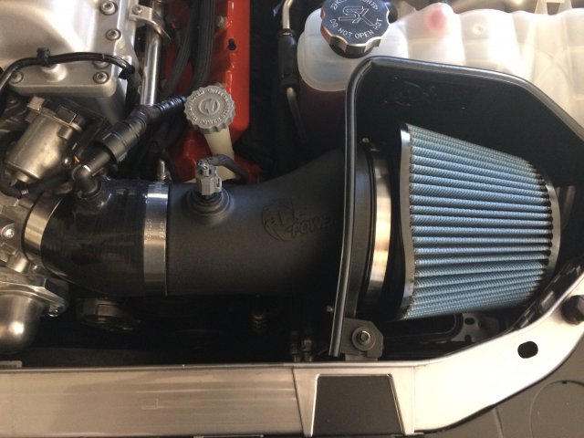

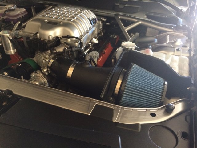

I don't want to down grade JLT bc its a good CAI but for me the JLT did not seal to the hood as claimed ( removing the hood vent & videoing inside is how I found out ) , the filter is almost too big for the box as it pushes to the end of the box , & the box just looked too big sitting in that spot.
The AFe doesn't have a box , it has a engine bay block off panel that does seal to the hood a lot better in my case & doesn't look too big , the filter is big but doesn't look squished in that area so it looks more natural in that spot. It comes with a pre filter for rain but mine is not a DD anyway.
I did get the JLT hood vent block off panel that I keep in the trunk just in case needed but with it off you can hear the whine from s/c better , which I like.
