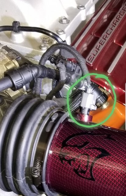

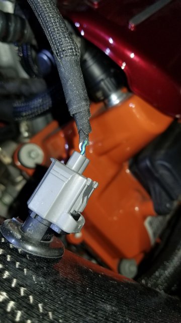

Exactly. I too want to know where this sensor is being read on the air inlet tube.. 20200512_161223.jpg
Exactly. I too want to know where this sensor is being read on the air inlet tube.. View attachment 17352
I wonder if it's used in the calculations. Like it takes reads from ambient, pre throttle body IAT , MAT and uses them to calculate something?

On my 2016 the dash digital gauge labeled "intake air temp" is the one by the throttle body I "think". Do the 2018 and up not have a MAF in the intake tube any longer?
#55
No . The MAF is gone on 2018 and up . Just the PVC and IAT sensor now .

Thanks to @Hpindy for the info on some other temp PIDs to monitor. I added manifold air temp and intake air temp. Intake air temp must be read in the intake tube as it was 4-5° F over ambient. Manifold air temp had the highest readings and aircharge temp (in HPTuners) lined up with what the dash gauge reads as "intake air temp".
