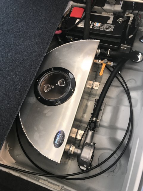

You want the EMP with the big Davies Craig pump. You can bypass and remove the OEM pump. You have two choices in tanks. One sits to the side so you can keep the subwoofer. The other sits in that space. You can’t seriously run one of these things in the Southwest heat without additional cooling. The stock Hellcats were having problems just getting down the full half mile due to IAT limits. They can do it in one day (all day). 4F2DBDE9-3E6A-4695-BCDC-FCBC5AC3E43C.jpeg

So I literally do not care about sub woofers. I have so much stuff on top of them that they do not matter. Where do I order the Davies Craig pump?

Buy the whole setup from EMP (Extreme Muscle Performance).

Got it. The emp pump is the Davies Craig pump.

Yes. They call it the Charger version. That’s the one I have. We are replacing the thermal spacers with Cometic gaskets. We’ll have those tomorrow so we should be back up and running for the Friday night event wherever that is and then race the quarter mile at WHP on Saturday.
