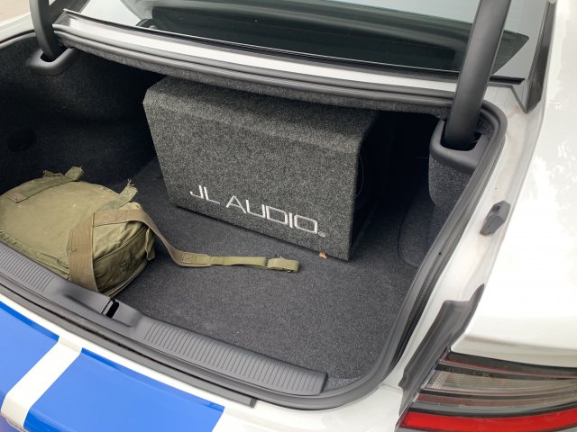

They didn't remove anything. On the Chargers I am actually not sure where the factory subs are. Ill post a pic of the sub in the trunk and then the amp installation after work.

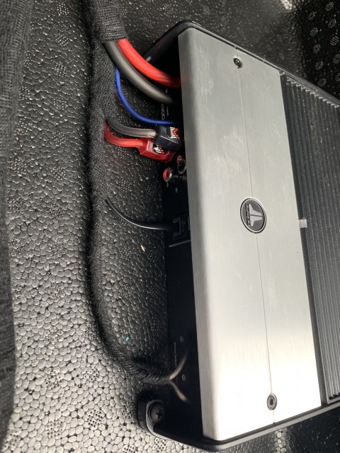

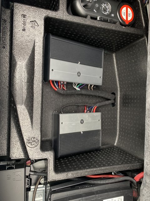

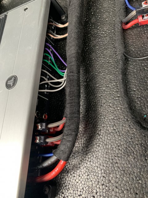

See attached. Hopefully it helps. If you need more clarification etc by all means ask!

This is great! Looks like you have more than originally stated and that subwoofer must be banging with the mono amp. You have two amps, and what looks like the JL Audio XD600/6v2 and the XD600/1v2, with the 6v2 powering the Front stage and that 1v2 powering the subwoofer.
Great system, must sound great! I cannot wait to dive into this build. Appreciate all the posts and pics!!!

Yes I’m sorry I thought I mentioned I had 2 amps. One is the 6ch amp for mids and the other is a 4ch amp bridged to the sub. It sounds like you would think a $1700 option HK system would sound like, absolutely badass.
