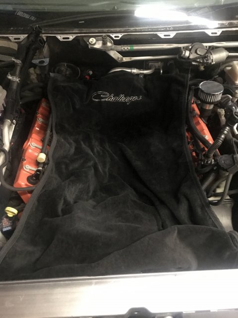

I’m getting ready to go faster
Super charger being shipped tomorrow for full port at jokerz EE760BBC-B4BE-477A-93AD-7F652DE758D1.jpeg

Nice, look forward to the results. You going to pulley up in size? You'll be moon boost with that upgrade...

I’m going to work around my 2.75 pulley I believe it will produce the most efficient air

Got to watch the IATs too. Might even have to use the 2.85. You'll probably get another 2-3psi with that setup, I wouldn't be comfortable with anything over 21 on a stock bottom.

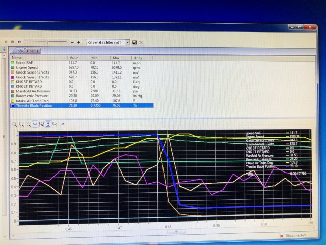

I just did about 3 weeks ago a before this upgrade dyno visit and plan on doing a after it’s installed visit and then possible another dyno visit if and when I port the snout and go with a 105mm TB. I’m one that like to know and prove out gain claims. I’m making about 17 psi now with a 2.85, I’ll be able to tell pretty quick based on data logs alone how much more boost the plate alone with the FM TB nets. I’ll be posting the data. This data log taken earlier today, if I’m looking at this right max boost was about 17.24 psi?? D20A4B40-3832-4B29-A373-9B2D172FAE0C.jpeg

Looks about right.

31.53 manifold pressure ..I thought was 16.5

Have to subtract barometric pressure, by converting in hg to psi, 29.20 in hg = 14.34 psi, 31.53 psi - 14.34 psi = 17.19 psi of boost pressure. That’s how I was told to calculate it at least

I always subtract 15 from my numbers

14.7 would be a better number to use as a constant, 1 atmosphere, very seldom is barometric pressure that high, it would have to be almost 31 in hg to be 15 psi
