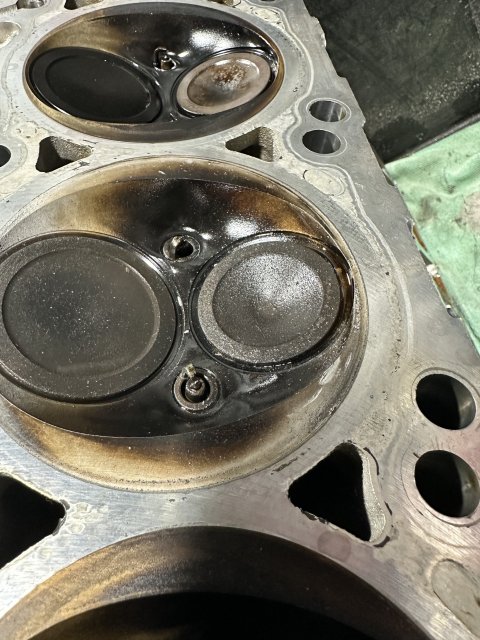

Better question is how did the spark plug look on cylinder 2? That’s the dead give away and I’m surprised no one checks plugs anymore with modern engines

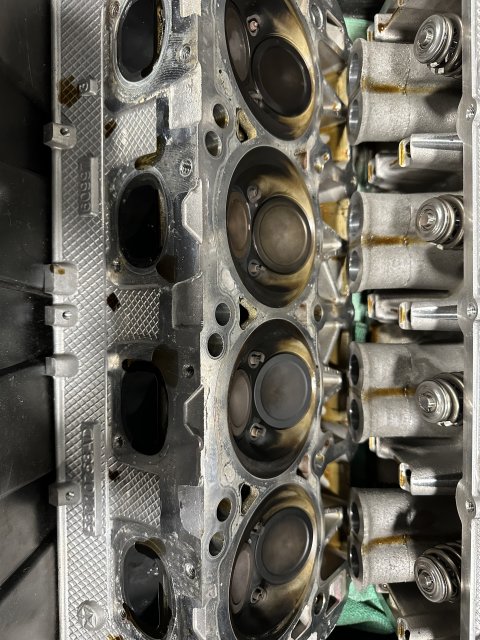

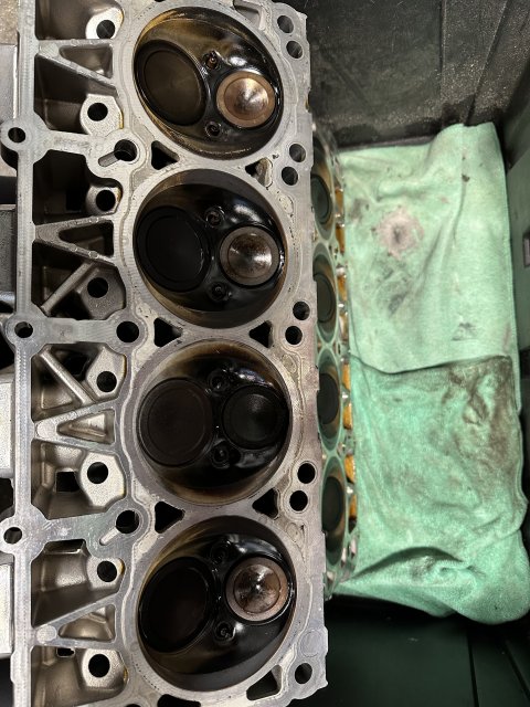

From the photos sent here, he had number 4 fail not number 2? To me it looks like heat in that cylinder caused this meltdown. Definitely not a defect.

If injector failed plug would show it.

Here are the pictures of the heads. Tough to tell from an image the plug condition. Hater can take a look for himself as well.
