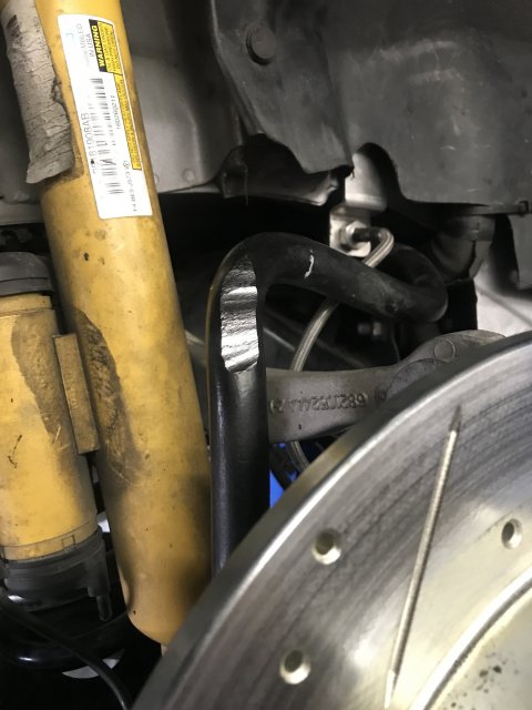

For those who might consider doing this but don’t want to live with the ground down pieces.... I heard rumor that Carlyle might be producing a rear spindle that would place the sway bar and toe arm attachment points so that the grinding wouldn’t be necessary. The AAD toe arms pretty much eliminate the need to do it there, but that sway bar point still has to be ground down to wtf! The Carlyle brakes are relabeled Wilwoods and are a very nice setup with good stopping power. No issues there. I know some will be going... why bother to do this? They can make the argument that cars on 17’s and even 18’s are running as fast as anybody. Yes they are.... on occasion. If ones goal is to log personal bests when all the planets align with track prep and other worldly conditions exist, then it can certainly be done without going to this conversion. In fact.. sometimes less tire is better. What you don’t hear from the guy who ran a 1.3 sixty on the way to that 9.5 quarter on completely stock suspension and 18” wheels is.... the other six passes were a bust and he had to get out of it or hit the wall. If your goal is to compete and go rounds you can’t have that. Consistent sixty foots on less than perfect tracks are what get you to the final round. Not a occasional unicorn pass for bragging rights when everything is perfect.
No argument from me Marc. A 30" tall 15"rim tire has a LOT more sidewall to get off the start line with than any of the other easier options.
That Carlyle spindle would likely make a very clean install.

Also had to grind in the sway bar on passenger side , it does make you question structural integrity 🤔
Sorry but way too much grinding for me .
Hmmm. Probably unnecessary question but.... is the bar centered? I replaced my sway bar with a 1320 bar and did not have to grind any on the bar. The stock bar has ridges that place it in one position. The 1320 bar does not have those so it can be moved side to side to place it where you need to get it away from the wheel if it’s too close on one side.
It could be off some but checking clearance on other side there was much injury either
Didn't want to be a downer when the first pics of the chopping and grinding of the spindle was shown (cause it's a great post and I appreciate the sharing of info anyway) but for a street car I wouldn't the 15's. Track dedicated, I can see it.
Wish youda called me before you did this. Coulda helped you eliminate 90% of the grinding
