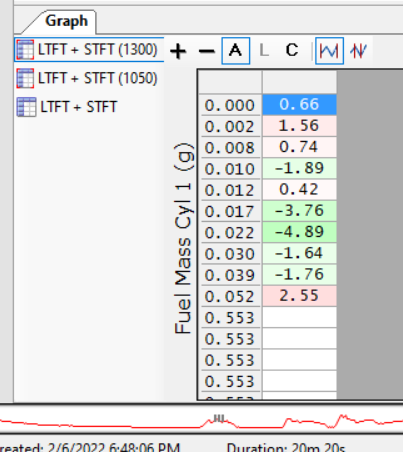

Well, you guys motivated me to dial the injectors in tighter. Thanks for the tip on the histogram setup, made it super easy.
I don't think I can get much closer than this. This is from a 15 minute drive and the values are an average for the entire log so dang close.
Just like you have shared many a tip with me, I'm glad I could help you out for once. I don't know what to do with the cold weather I'm having. Right now it just seems because of the cold to want to dump fuel in. I don't plan on any more injector tuning till the weather is above 40*.

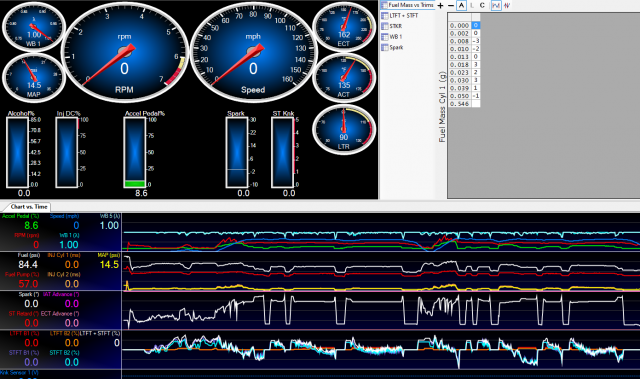

Yeah I was definitely doing it the hard way. It worked but was super time consuming. I'd watch the trims at various inj pw then go in and adjust the pw by trim % give or take a little. The fuel mass way worked 100% better. Somehow I had the trims 5-7% with the DUMB way, but now they're super dialed. I'm gonna do the same on my E85 tune to tighten those up.

When I was doing this...I setup the STFT+LTFT vs both IPW and Fuel Mass (2 seperate histograms) so I could see the difference between the 2. It is sometimes quite substantial to say the least.
I usually ended up adjusting fuel mass instead of IPW but could never achieve any sort of progress in the low pw areas of off-idle cruise and whatnot. I would have it bang on one pass and 10 off on another.

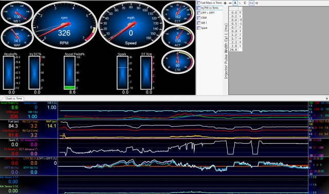

Ok yep I went back and added a histogram to log inj pw vs ST+LT fuel trims and it lines out, so it's two different ways of accomplishing the same thing. I had just been looking at logs in the charts area for fuel trims and adjusting the fuel mass at specific inj pw points in the tune. Same same the histogram just makes it way easier to know how much to adjust although I always did 50% as I dialed them in. Took a couple extra logs but better than over shooting.
7,230
18,817
Here's what the INJ PW histogram looks like for those that are interested. This sorta makes more sense to me as you're manipulating how much fuel mass is injected at a specific pulse width on the injector.
