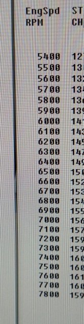

Going to be pushing my 16' Hellcat to 7600 - 7800 :giggle:......
And sweeping it up with a broom! LOL

I think that I might be a little past going to a dealer for anything.

6800 on my redeye.
6,800 is a lot different than what @NTB is looking at 7600-7800 is just looking for trouble.

Interesting, but did you say whether or not this was the stock valve train or an upgrade???
Nothing is stock on mine, if it was I would be "sweeping it up with a broom". I'm sure Dodge got the Max RPM right for the components that they provided. Perhaps I should have mentioned that it isn't stock first.

My apology you know what they say about assume, I assumed it was stock. Now this is going to be interesting, can you tell us what the build is. Promise not to assume again or have doubt
