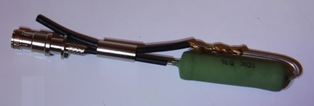

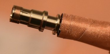

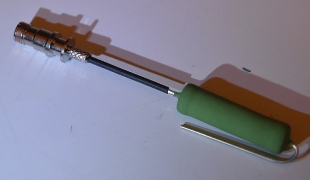

In the FSM, under cell troubleshooting, they call out for a specific miller tool, to load the cell module, once the antenna is removed. Simply unplugging the antenna is NOT recommended, as it can cause damage to the mode.
The Miller tool has a load of 10k ohms. You could use a much smaller resistor, but it is difficult to add the faraday material to a 2 watt resistor.
I went with a WW resistor, because I wanted a 1%, close tolerance load. There is a small +/- window that HAL9000 is looking for. Anything outside that range and you will throw a code.
