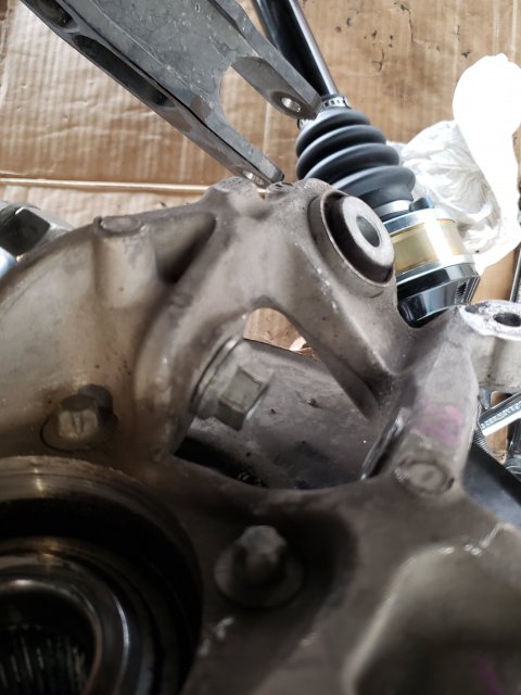

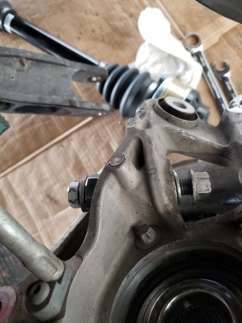

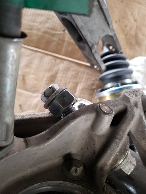

This has come up before and Jon found a way to do it but after having an issue with his bolt I figured out an easy fix. Once you pull the knuckle off there is a little sleeve that sticks out making it impossible to get in back on. All you need is a bigger nut or small spacer to fit over bolt and a washer but it may not needed in a pinch. The bolt and nut, you have them lying on the floor from disconnect the arms. They are 18mm and all you do is tighten them and it will push the sleeve in. I used 2 18mm wrenches 20230924_111702.jpg 20230924_111636.jpg 20230924_111628.jpg 20230924_111641.jpg 20230924_111227.jpg
