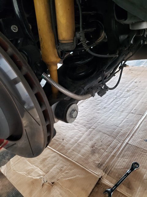

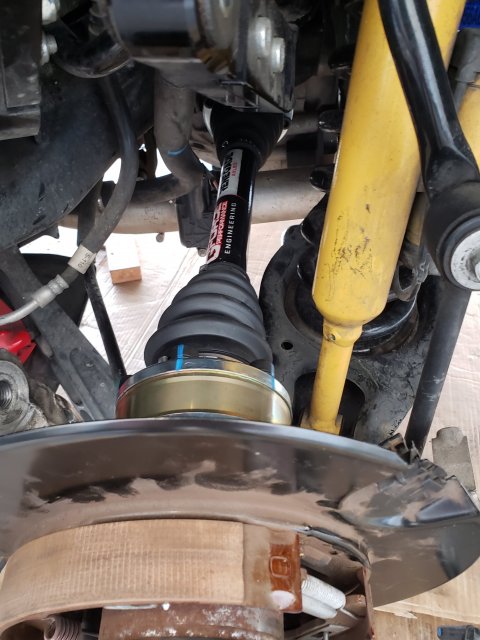

You unbolts the upper control arms, trailing arms, sway bar, knuckle, alignment bar and come out the side 20230924_121053.jpg 20230924_093117.jpg 20230924_093057.jpg

Doing it both ways it seems to be faster dropping diff
17,292
54,106
It seems less invasive to me, also avoids alignment possibilities

Stock axles have so much play they practically fall out dropping diff. Aftermarket are tougher but my renegades were not bad. We tore up both boots trying to get the outlaws out on jons car, there isn't a lot of movement in them
