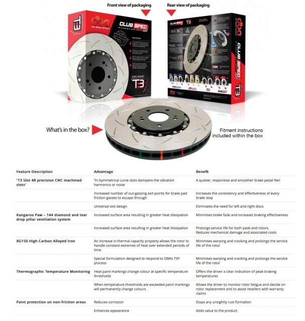

Hey @MiHiHemi I love those rotors and have been looking for them for my DD. I had a member from DD.net give me a pair of the front aluminum hats now I'm looking for the rotors. Any chance you have a model number or part number. I'm putting them on a 2021 DD tow n go which has the brombo big brake package just came with 1 piece rotors originally.
MiHiHemi
#1016
835
2,520
Parker
2015 Challenger SRT 426
Here’s all I have handy...

new hardware is available from www.knsbrakes as well which is what I used recently when installing the DBA T3 5000 rings to my front hats
