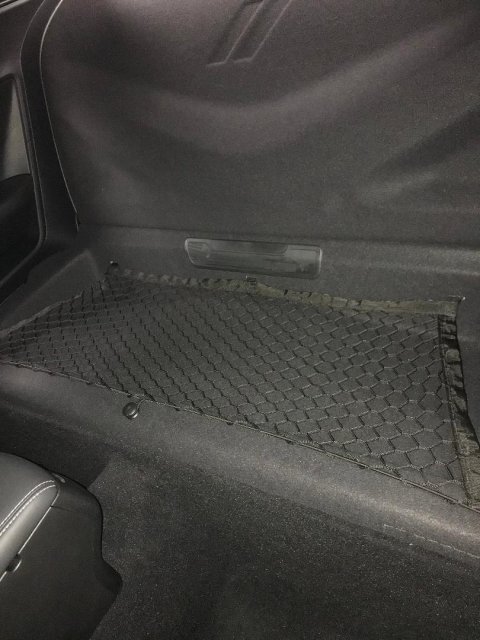

I ordered a Rear Seat Delete Kit today...finally, it’s here!!!😁

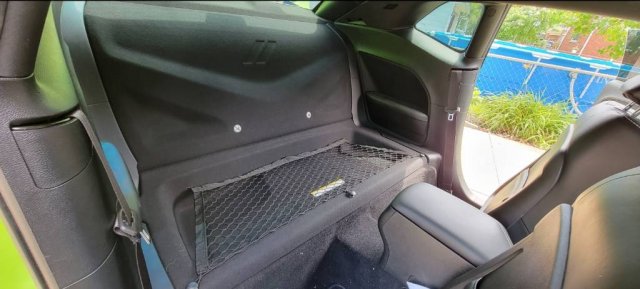

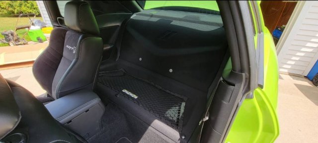

Decided to keep the seat belts installed so I could go back to having the seat easily if I needed or wanted to
Remove the bottom cushion and the seatback
Remove the push pins on the front of the pkg tray (one each side) and the larger ones below them.
With the package tray still in place, CAREFULLY cut the tray around the seat strikers so you can get to the bolts, remove the strikers and remove the bulge making it flat like the tray that came with the kit.
Reuse two of the bolts and install the crossbar
put push pins back in
put top delete section in
Put bottom section in
DONE
No pulling trim pieces no removing passenger seat etc etc.
To reinstall back seat, pull delete kit pieces out, remove the cross bar, reinstall strikers and put the seats back in.

Is the net easily removable?
2,617
7,200
Thread Starter #185
@TrackDay yes it is. Easily.

Well lets see.....
Total weight of the seatbelts with mechanisms and seat strikers are 7.5 lbs. The lower buckles are 2 lbs total.
The weight of the seat and seatback are 49 lbs
The weight of the delete kit inserts are 8 lbs total.
So I removed 51 lbs of weight, and put back 8 lbs. for a loss of 43 lbs.
had I spent the hour to remove the 3 seatbelts and mechanisms Id have saved an additional 5 lbs.
Your right, leaving in that 5 lbs defeated the whole purpose, what was I thinking......

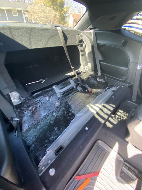

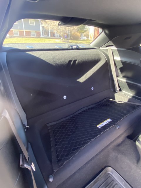

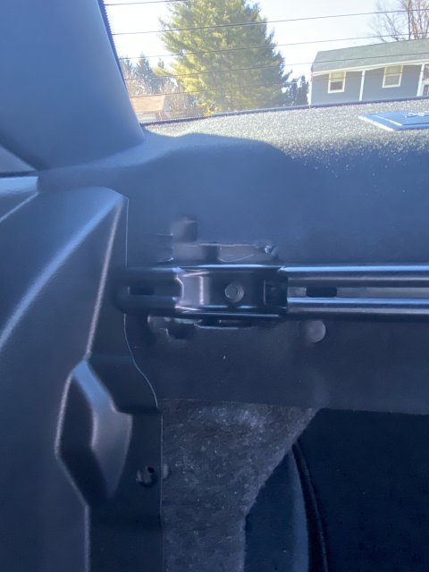

I did mine more for the looks. I think it looks cleaner. Screenshot_20210724-015501_Gallery.jpg Screenshot_20210724-015447_Gallery.jpg Screenshot_20210724-015430_Gallery.jpg

I actually wrote a thread on the install awhile ago. And yes one of the things I mentioned is the contortions laying in the trunk. I actually removed it from my '09 SRT8 to put in my RE. The removal (of the bottom part) was worse than the whole install.
Thanks for the pics and install info.
I'm in pain just thinking about doing that. It reminds me of stuffing myself under a sink for a plumbing repair.

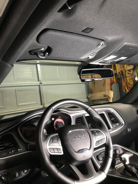

coolblue, How did you get the white/yellow warning sticker off of the center of the bottom piece?
I would like to remove it but am afraid of leaving pieces behind and then it would look worse.
Thank you,
Varooom
2,695
Thank you,
Varooom
Actually that one practically fell off. If you hit it with a hair dryer or heat gun (Gently! on low heat) it should come right off. You may not even need it. The other two on the upright back portion were way trickier. I had to heat them them some then pull a little, then play some more then use a fresh new straight edge razor and slice them gently off the fibers. Then I blended the felt like material left behind with a small nylon brush. If you look close you can still see slight circles where the medallions used to be but I don't care I think it looks way better imho.
I removed the ones on my visors too. But that was waaay crazier and more work and involved. (I posted all this back-aways but can't remember when or post names).
