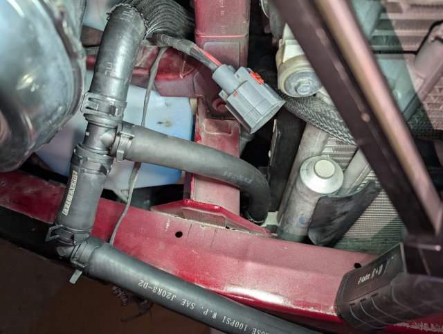

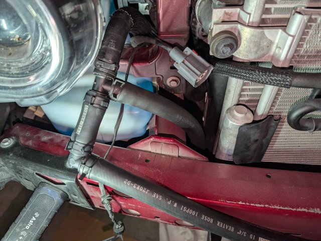

T on passenger side:
- factory hose originally from SC cold hardline to HX outlet is relocated to come off the T
- new short line from HX outlet to T
- new bypass line from T across top of bumper to 3-way valve on driver side (T to short piece to 90 to bypass line across)
Bypass (chilled) flow goes through 90 then straight through T, non-bypass (HX) flow goes through 90 bend in T

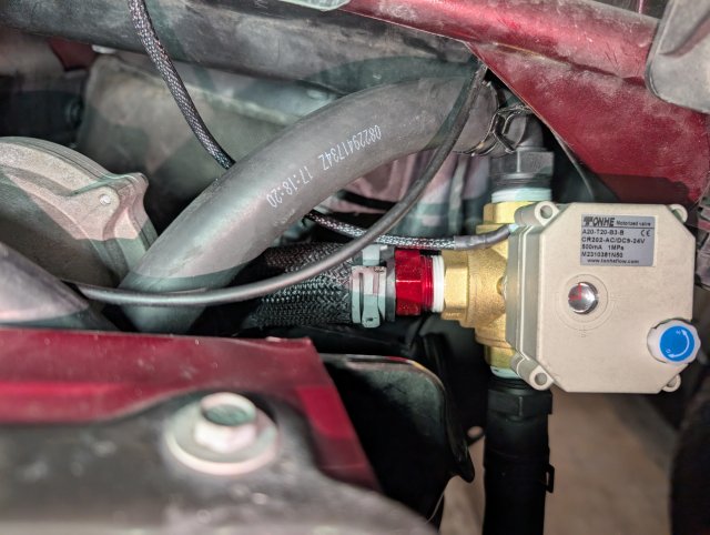

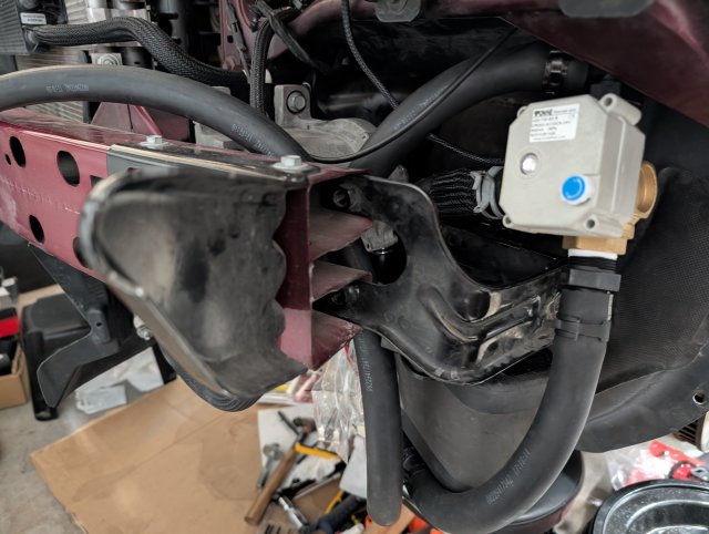

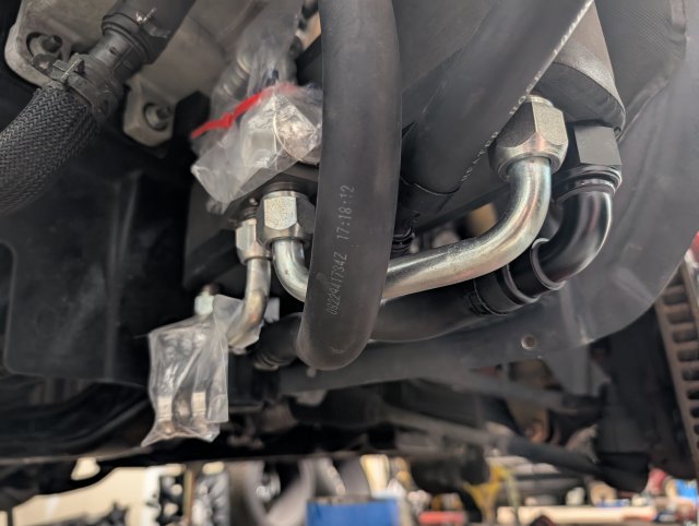

Driver side: 3-way valve comes straight off pump outlet:

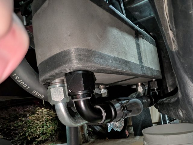

Driver side: 3-way bottom outlet goes down then through a 180 bend into the IC Chiller brick outer-most connector:

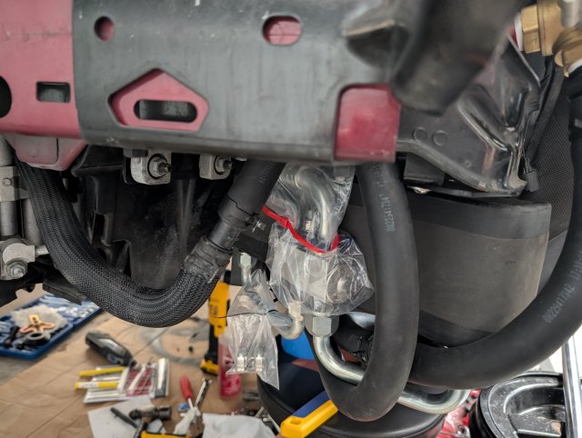

Driver side: 3-way top outlet goes down with a 90 and small new hose, joined to the factory hose into the factory HX inlet:
View attachment 153959 View attachment 153960
View attachment 153967 View attachment 153966
