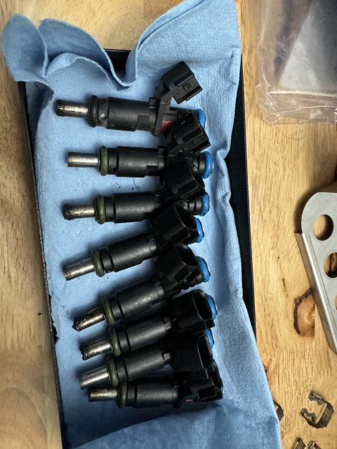

Customer was having issues. The car was stumbling. Initial inspection.
With injectors this dirty I like to let the intake end soak in gasoline for a half hour.
After three uktrasonic baths they are finally clean enough to hit my good fluid and be flow tested.
In case you wonder why I clean so much before flow testing. I use some pretty solid calibration fluid, this was the injector cleaning fluid after bath #1
Turned the fluid black. Don't want that in my testing machine. But they are ready to flow! Remember for the rest of the year, 100.00! All 8 injectors!

Those were filthy! Any idea how many miles on them and what fuel they used?
3,550
8,646
Customer is a procharged 6.4 Charger running e85. Built bottom end but has no inclination to go faster. Its his weekend fun car for him and his son, says its just fun having an 8psi charger for those that want to play games thinking he’s stock.
These are factory Hellcat injectors. Our assumption is without a properly vented catch can to atmosphere the cylinder was retaining moisture and gumming the injector.

JFC!! those were horrible. Awesome deal.
49,607
159,817
None of my injectors have ever looked like that

Got Blow by?
3,550
8,646
It is a possibility that is happening @Unholy707 I believe his 6.4 is still using the plastic intake and the gaskets are the 6.4 gaskets just like the 6.2 that have the opening.
5,536
4,567
Yep and the oil fill port, they actually use that provision on the head. I wonder if there’s oil around there/the intake manifold, pretty common problem with the 6.4s
