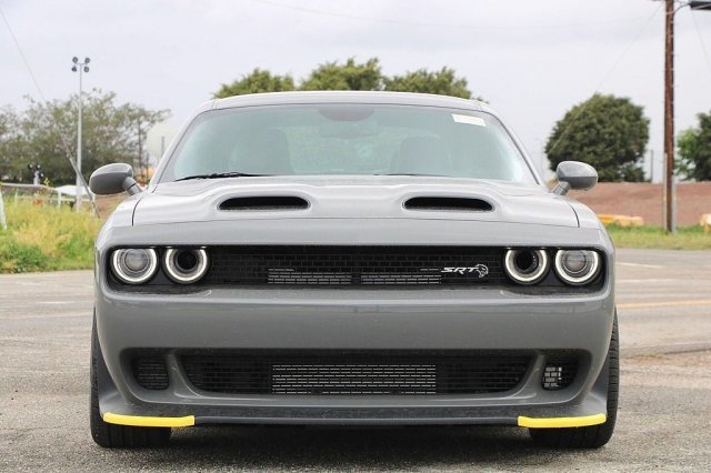

Is the passenger side hood scoop on the Redeye is non-functional?
LonestarHellcat
224
158
I was watching a video and someone mentioned that the passenger side of the hood scoop on the Redeye is non-functional. Is that true?

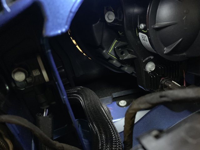

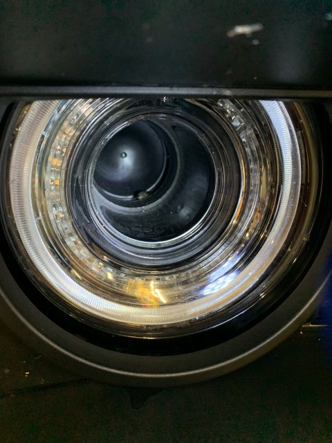

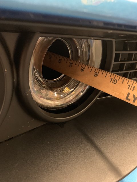

BDE57873-FC45-4F49-AE83-86A735318DBF.jpeg 6941FF6A-2531-4168-9197-65761F17F615.jpeg B0A86341-5447-4763-94DA-00FC90C6DB18.jpeg On the Redeye, the passenger side is capped at the back of the headlight housing. The hole is about 8” deep. The cap can be seen from under the hood.
So its non-functional but if you want to pull the whole front off the car, you can remove two tiny screws (in picture by the white decal) and remove the cap. There is an electric harness back there that may get wet at 200mph in the rain.
