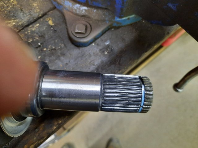

Honestly, with all of the people twisting the force axles I don’t think I’ll ever do anything besides redeye ones. I hammered on these axles twisted them everything and they’re still great (stock 2015 axles). No spline twisties at all

is is my stock broken axle that I removed yesterday, twisted

Yikes, year/miles/whp? Mine look straight as an arrow
I ordered this car in 2015 got rolled into a 2016 so was a early 16 build, has about 7,000 miles on it.
its got a built 411 with 3.0 whipple. car ran 9.33 at 147 with stock 2.4 blower 1.38 60 ft.
been to the track once since whipple installed an snapped L.side axle. I knew is was just a matter of when, not if.:sick: I have a wavetrac an outlaws to install. will soften up the launch so not so hard off the line.
