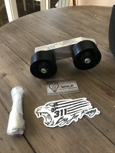

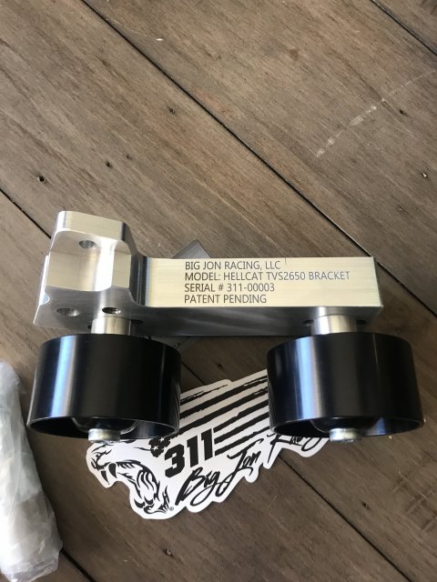

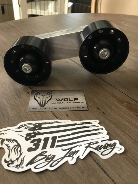

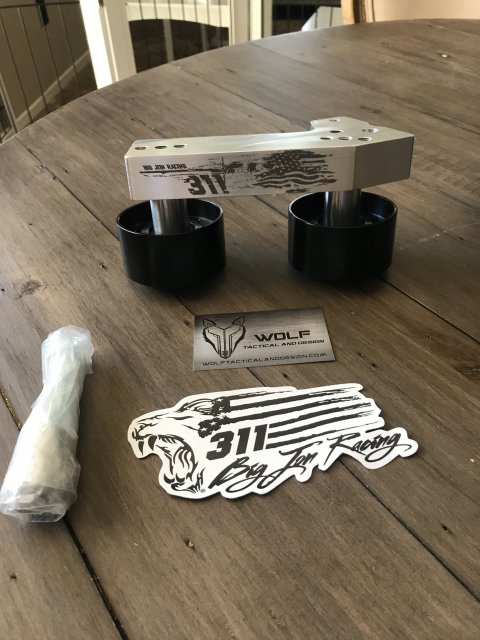

Update update lol it’s finally here! Plan is to hit the dyno next Thursday & install the day before.
DDBB562E-2F51-4DAB-AADB-6C2B47C7AADD.jpeg 74528DDF-5148-4629-8FE0-C9F80CAAA88B.jpeg 8080D689-A782-4DF7-BDEC-A5F143481120.jpeg 8080D689-A782-4DF7-BDEC-A5F143481120.jpeg 39DE9BDD-954B-4423-B110-866F340BA8B2.jpeg
