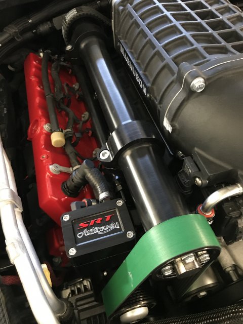

After a long all night race to get home instead of chilling at the shop for another day.... I can comment on all of this. I’m playing around at the shop thinking about having a Corona (beer) and I get a call from my wife telling me that she just found out that Utah is restricting border crossings on Friday. I’ve got a 8 hour drive home and if I don’t want to spend the next week living in a motel in Phoenix, I’d better get my ass moving! Strange times we’re in! Anyway.... disappointed to not get the results with Primetime we were hoping for. That brings up the subject that I’ve experienced over and over. You try to get the info you need from the manufacture of whatever you’re buying and there’s nobody to talk to that knows shit. The first thing that popped into my head when I saw the Maggie on James motor was “Is that belt on the right side of the tensioner?” Of coarse it was..... but the angles that the belt runs is just not putting a lot of wrap on the pulley. Not a problem I guess...... until to put 25 lbs boost to it! Tommy already recognized that the stock tensioner wasn’t going to cut it, so that had been swapped out with one of the heavy spring billet pieces. That belt was tight! Not enough 😳. It smoked that thing like a big fat stogie. So now it’s getting a Griptech and a idler pulley added to the need to have stuff to make it work. That’s all news to Magnuson. Anyway..... next week!!!! Unfortunately I wont be there so I’ll be waiting on the results with everybody else. One thing I can say is.... man that thing is beautiful and sings like a bird! 79BE159E-F485-4078-8602-9B5F742E47DB.jpeg B9F2883E-ED1D-4BA1-91D1-0119BE229220.jpeg 78DA0EE6-0FE2-48B4-A701-3533100DAAA9.jpeg

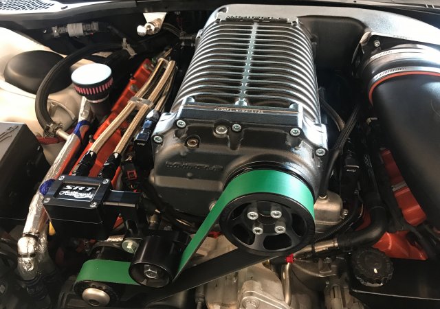

Hey if it fit and worked right out of the box then it wouldn't be a hotrod lol.
Btw I see what you mean about the pulley/belt . You almost want to get a non ribbed pulley and put ther belt on ther other side of it .

Yep. When you look at the belt wrap on the Maggie compared to what I’ve got going on my Whipple, it’s obvious that it could use more. 9AF44A65-654A-45F2-90A1-E36372EC23F6.jpeg

Yep. When you look at the belt wrap on the Maggie compared to what I’ve got going on my Whipple, it’s obvious that it could use more. View attachment 15628
I wonder if the direction the tensioner pulls in relation to the SC pulley makes a difference?
Yeah it pulls away (or out) from the pulley so it isn't helping any. That billet tensioner is killer compared to the stock tensioner. We had to put one on mine and that belt is under control now. We threw the belt with the stock one. I'm betting that with the idler increasing the degree of wrap on the pulley along with the Griptech will fix this problem with the Maggie. It would just be nice if they had that information to start with.
Yup your right on the money with 80% of these dam sales people. They don’t know a dam thing about the product their selling. Now Grip Tech had outstanding customer service, now let’s see if they send us the right pulley lol. Then this morning on IG Magnuson reached out to me stating hey reach out to Grip Tech we use their pulley’s all the time...🙄🙄🙄 I’m like really! Could of told me me that from the get go😡. It’s all good though...... I learned a lot from Marc and Tommy these past 2 days. Oh ya 1 more thing..... from having the 3.0 Grip Tech pulley, their tech said I will gain about another pound of boost because hopefully zero slippage.

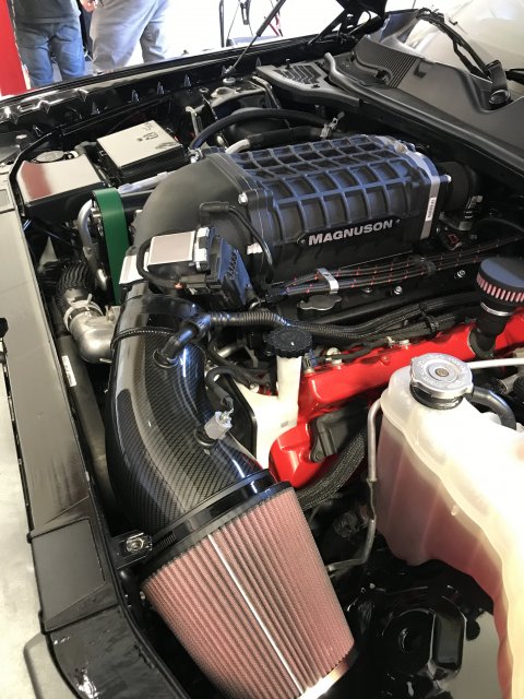

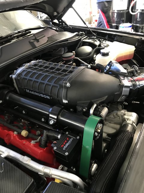

After a long all night race to get home instead of chilling at the shop for another day.... I can comment on all of this. I’m playing around at the shop thinking about having a Corona (beer) and I get a call from my wife telling me that she just found out that Utah is restricting border crossings on Friday. I’ve got a 8 hour drive home and if I don’t want to spend the next week living in a motel in Phoenix, I’d better get my ass moving! Strange times we’re in! Anyway.... disappointed to not get the results with Primetime we were hoping for. That brings up the subject that I’ve experienced over and over. You try to get the info you need from the manufacture of whatever you’re buying and there’s nobody to talk to that knows shit. The first thing that popped into my head when I saw the Maggie on James motor was “Is that belt on the right side of the tensioner?” Of coarse it was..... but the angles that the belt runs is just not putting a lot of wrap on the pulley. Not a problem I guess...... until to put 25 lbs boost to it! Tommy already recognized that the stock tensioner wasn’t going to cut it, so that had been swapped out with one of the heavy spring billet pieces. That belt was tight! Not enough 😳. It smoked that thing like a big fat stogie. So now it’s getting a Griptech and a idler pulley added to the need to have stuff to make it work. That’s all news to Magnuson. Anyway..... next week!!!! Unfortunately I wont be there so I’ll be waiting on the results with everybody else. One thing I can say is.... man that thing is beautiful and sings like a bird! View attachment 15624 View attachment 15625 View attachment 15626
Thanks for posting those pics. Way better shots then what I took lol.
