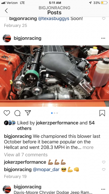

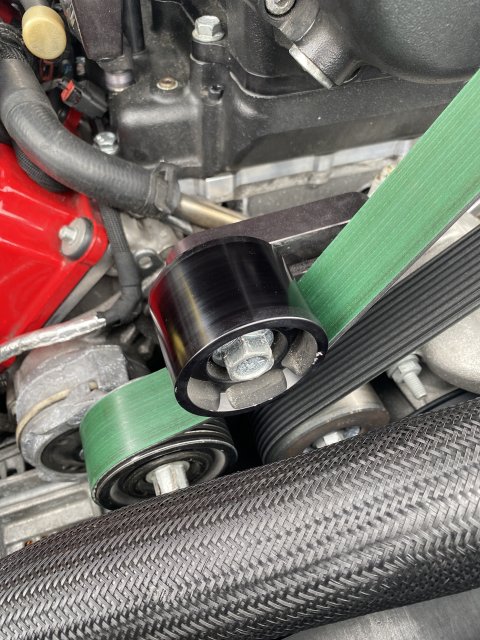

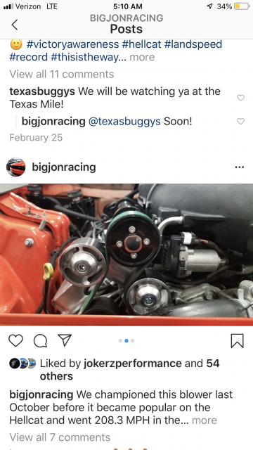

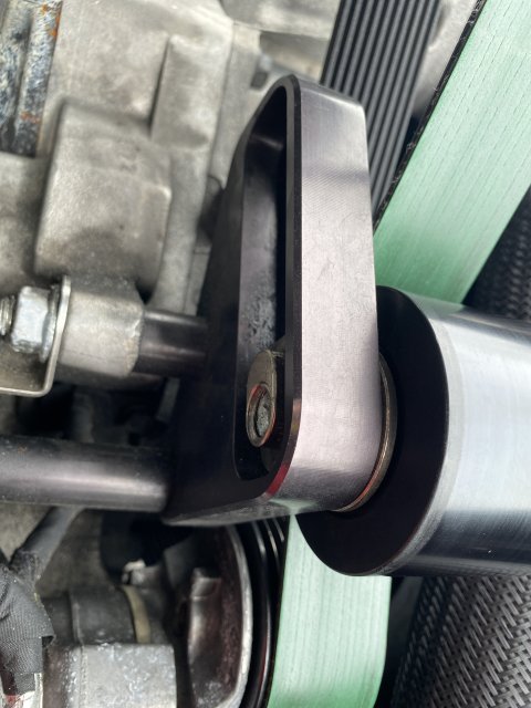

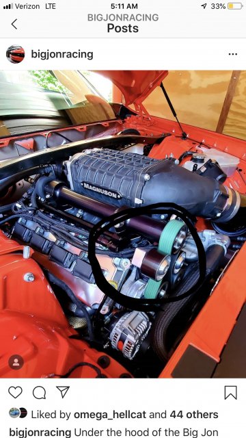

Has anyone seen a set up like this? My main attention is to the bracket that was made to hold the 2nd idler pulley in place on top. It helps with a lot more belt wrap as you can see. I was able to reach out to the 2 shops that have done this with there big builds running the magnuson. I’m finding out that with 1000hp plus to the wheels running the magnuson I’m not the only one experiencing a lot of belt slippage. The 2 shops will not be making anymore of these. I have made numerous calls to almost everyone including magnuson and no answer or help. This is turning out to be a big issue for Magnuson. They need to develop a bracket like this if they wanna keep up in the SC Mopar world. I did talk to Jokerz Performance and they are all in on making a bracket for me but they don’t have access to a Hellcat right now to get the correct dimensions. I did chat with bigjonracing and he had all the same belt issues I did till his shop made that billet bracket for him. C3D0CEB4-E8AE-426A-998F-09E18AE75A82.png 7C9027F3-D230-4A6D-A90C-0FE8BA9D9006.jpeg B660C26E-8F6A-495B-AFA7-800D51BB4E57.png

Why don’t you look at the one whipple has for the 4.5
I have it, and I think it will get the job done.
mines pushed over and cranked down like a son of bitch.
I rip it quite a bit on that and no belt slip. It will
Slide over occasionally and I’ll get some slip again.
I can hear the belt slip so I know when it’s loose.
