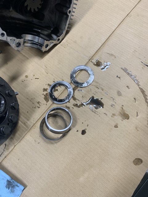

I’m hoping it just makes sense when I get home. Everything is back together besides these shims. When i pried out they came out without being ready. I believe they all go on the driver side. But if someone is exactly sure that’d help.

On the 1 that I took apart I think it was evenly shimmed on each side, not 100% sure on that but I think so.
Put them back in like that & put some gear paint on ring & pinion & bolt the 2 halfs of housing back together snug & rotate the ds yoke a few times & take back apart to see how the pattern looks on the ring & pinion, if looks good, fine, if not, adjust shims from 1 side or another to get a good pattern.
I guess you took break cleaner & cleaned out all the parts & inner housing to make sure there are no small pieces of metal anywhere ?
^^^^^ +1
Since there's a wear pattern already you can compare against that to see if it matches or shifts to either side.
5,210
9,669
And see if the shims are the same thickness or not , & adjust according to that if needed.

Kind of restating what's above.
Shims in a differential need to go back exactly where they came out of. They adjust the lash between the gears in a precise way. Not only do you have an established wear pattern, but it also needs to be in the correct spot!

Based on his pics we think they were both on the driver side. The passenger side only shows a c clip

I told him to pry slowly incase there were loose pieces and he said it flew apart and is why his leg and foot caught it
I will say for not wrenching on something like this before, he is doing good:)

So if that's the original pic b4 it came out then there's your proof, shims on both side.
That's a good point to take a lot of pics as you take something apart to refer back to.
Good job so far Jon.
edit- shims on both sides.
