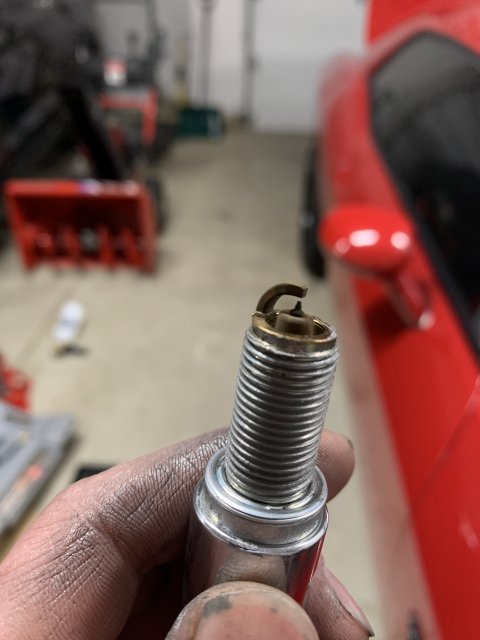

@Speedy! i know how much you like octane boost pics.
I had some in the car because I ran it around on 93 a bit for storage and put octane booster in. Well just have backing out of the garage and running it. Here is a brand new plug with 10 minutes of run time.
5,210
9,669
Looks good to me

5,210
9,669
Just stained a little bit nothing crazy.
I hope your #4 recovers for ya.
How much boostane did you use ?
I normally use 2 > 2.5 oz. to 8 gal.
4,385
10,911
Thread Starter #510
I don’t remember. I think I just dumped some in because I wanted to get a few last pulls in before it snowed 😂
17,564
54,998
10min on a new plug?
Looks dirty to me...

5,210
9,669
.01
I don't think they stay new & shiny looking very long.
10 min. of hammering down :LOL:

5,210
9,669
Another thing I feel if the cylinder was bad the plug would be oily. So I am feeling extremely confident the engine is fine.
Good, but what you think caused the plug to desenagrate like that ?
