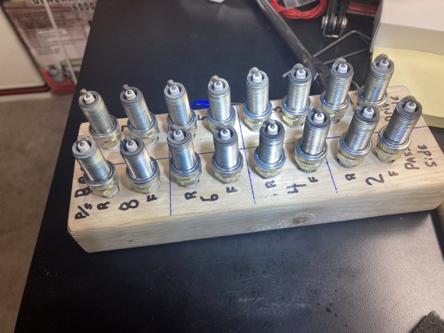

Been running NGK 2309’s since my first pulley on the car. .028 at 16 psi, .025 at 20, and .022 now at 24-25 psi of boost. These plugs had about 1000 corn miles on them when I put the Whipple on, they went back in as is with the ported heads and now running the 2.4 at 21-22 psi still with the .022” gap.

love that idea! ill be making one of those blocks soon!

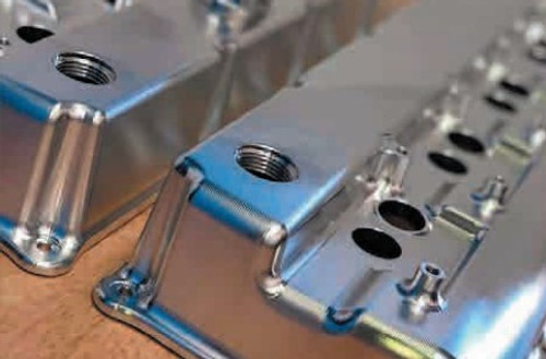

I did a thing, fuck those valve covers. Got some Mantons on the way. If Im going to keep doing this I want an easy spark/coil jobs. Also the BMR tank will be going. Cant decide on bumper mount or trunk…

I was able to do trunk mount without cutting any holes.
My thought weight in the back is better than the front.

They are nice covers. I have a set

Please don't think me a dick, I wanted to buy yours but they are more for a real race car. The ones I got from Manton dubbed the "Hell" cover have the baffles in them.
And I can still route to the front with my existing catch can system. Now plugs won't be a fucking absolute nightmare. It's worth the time saved.
