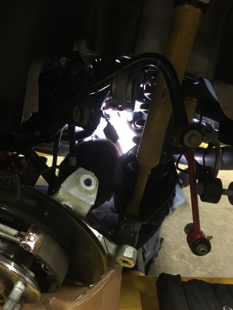

So my tips for anyone who has not done axles on a car.
Obviously disconnect everything. Sway bar link, control arms, trailing arms. Take the caliper off as well. I zip tied it up so it didn't dangle.
There's a 12mm bolt with a nut on the end. Take this out!!! I saw a video online and they said they didn't have to do it. Well that was my hold up all morning and my struggle once I took that out came right out.
If you end up taking the hub off I had to hit it with a rubber hammer.
Don't pry against the axle. I didn't know it but new axles don't come with that end piece.
A screw driver was enough to pop it out of the diff.
After doing the driver side and struggling the passenger side only took me just over a half hour.

Is this needed. I prayed on this side
60,936
212,808
I'm sure it did but we were not prying at that end so they would not have been damaged
