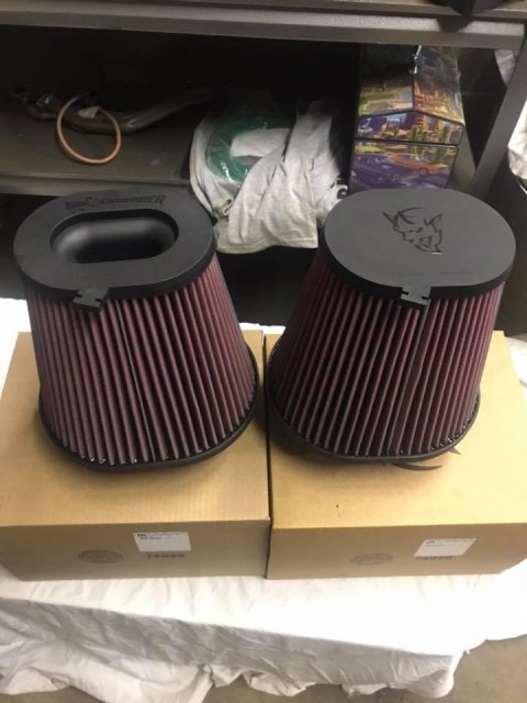

Is there something wrong with the Redeye filter?
The guys that are trying to buy the Demon filter are usually trying to buy the Demon RACE or Crate filter to get a High Performance filter for their Hellcat or Hellcat RedEye. They all physically interchange.
I am pretty sure the OEM filter for the Hellcats is the same as the Demon Assembly line filter or street filter
I was told by my connection at K&N that the Demon street filter is 4 layers of gauz and the Race filter has 2 layers. The race filter also has a flow director in the end and the street filters do not
. 44566128_10212151036363323_1021101867301601280_n.jpg ..
