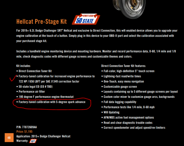

I was saying, just do your research and really understand what you're getting. Most people won't, and Dodge is counting on that I'm sure. Notice they call it a "touch screen device" which misleads you in to thinking it's the build in touch screen and will work like the Demon when in reality it's a hand held tuner you mount to the windshield, IE Diablo T2. So what that's gonna mean is you have to load tunes and data log and a lot of you guys seem to want to avoid that.
Also the part circled in red makes ZERO sense especially for the "pre stage" kit. It says you pick up a measly 5HP but then says it's a factory tuned cal with 5 deg spark advance?? What's that mean? 5 deg on top of a normal cal would net over 50RWHP and it's not possible to do that on pump gas anyway. When you finally step up to a pulley you get 40HP for over $2,000 BEFORE install charges to keep that precious warranty. 40HP wouldn't be worth it for me. If I'm going in there I want 100+.
@DGatzby 80% of the performance improvements in custom tunes are in the transmission and throttle response. I don't see them mention transmission tune updates, did I miss it?
