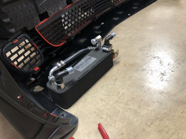

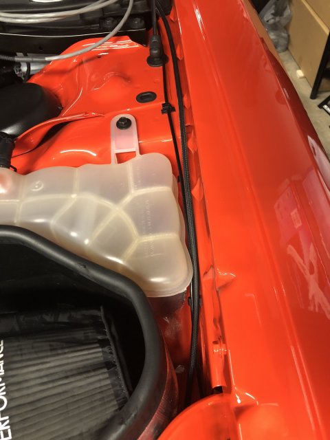

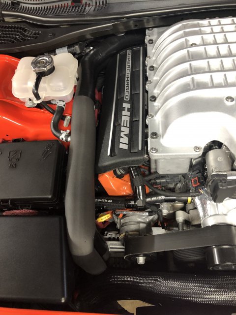

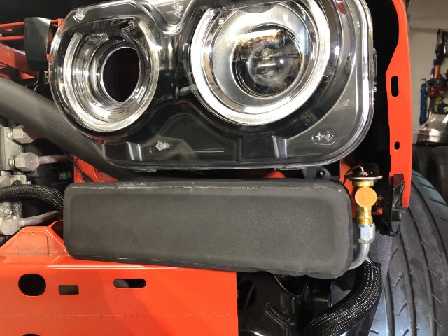

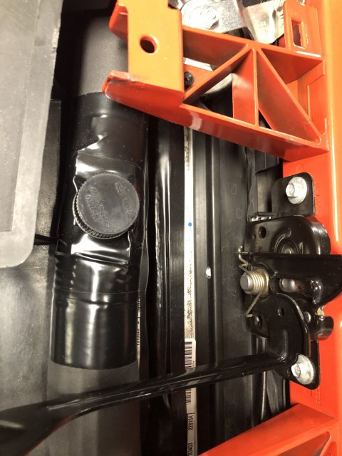

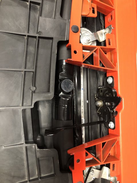

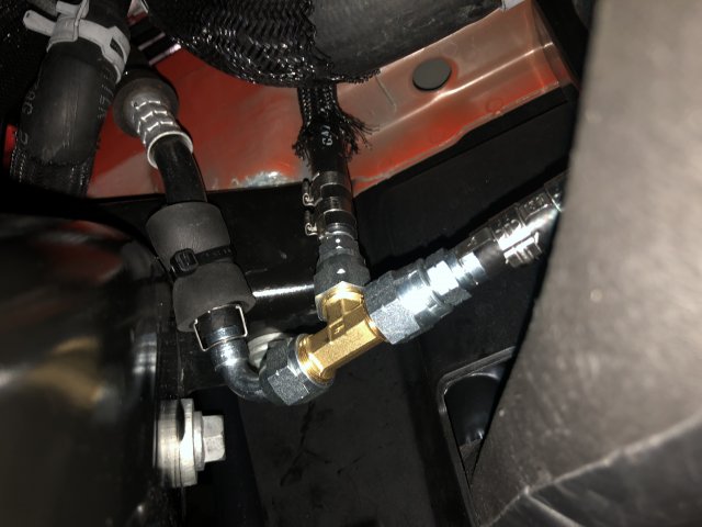

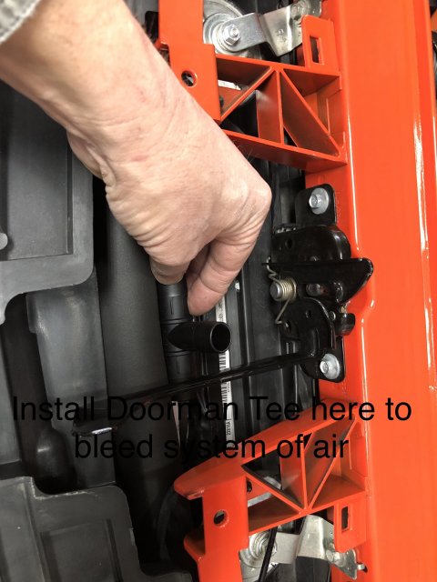

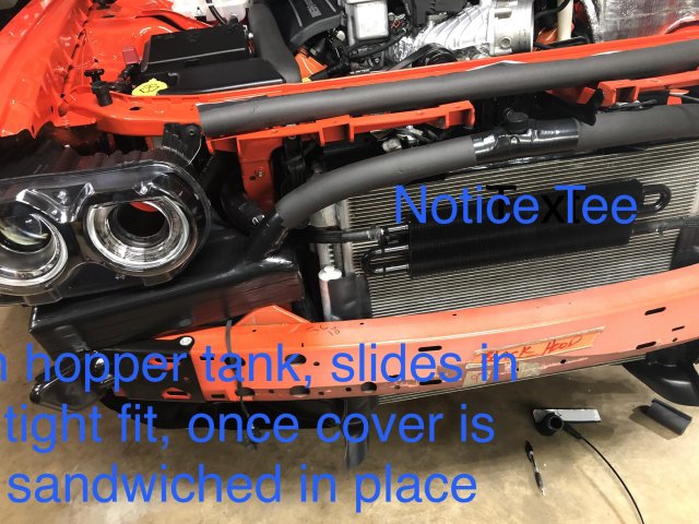

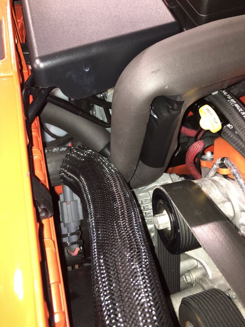

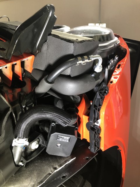

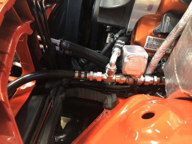

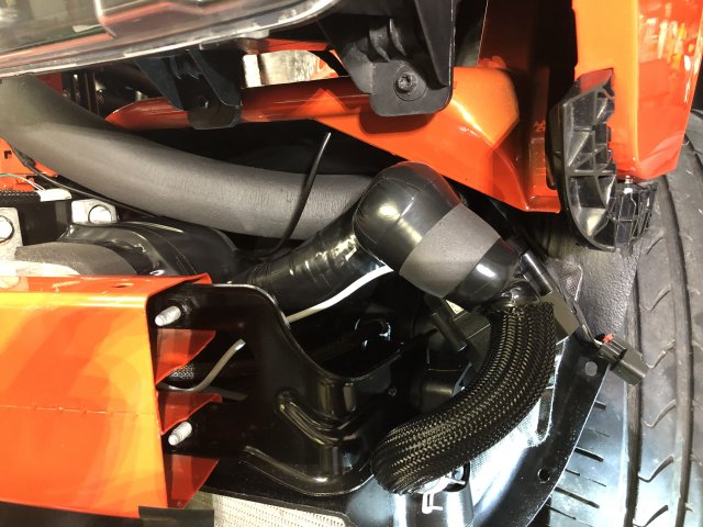

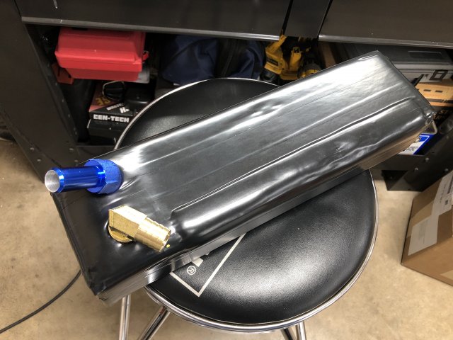

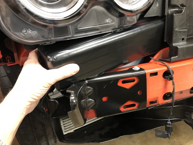

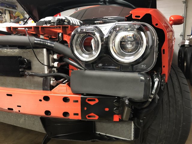

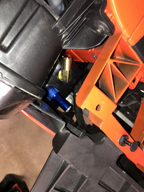

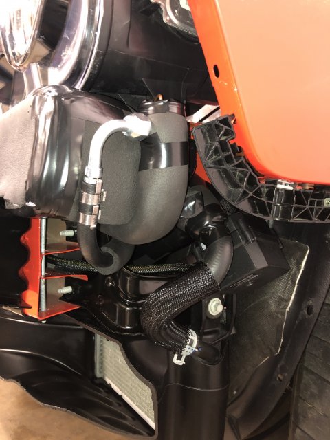

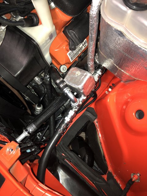

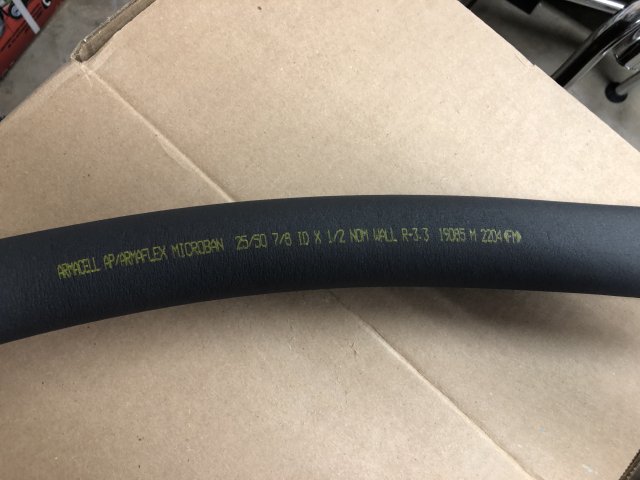

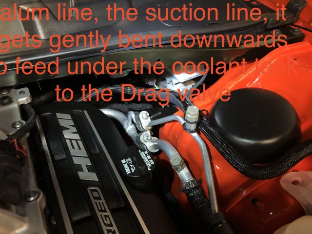

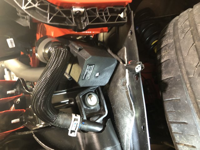

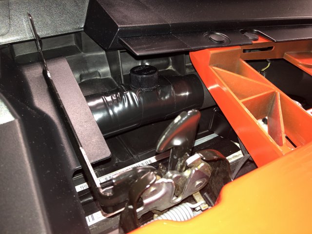

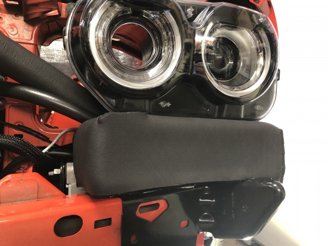

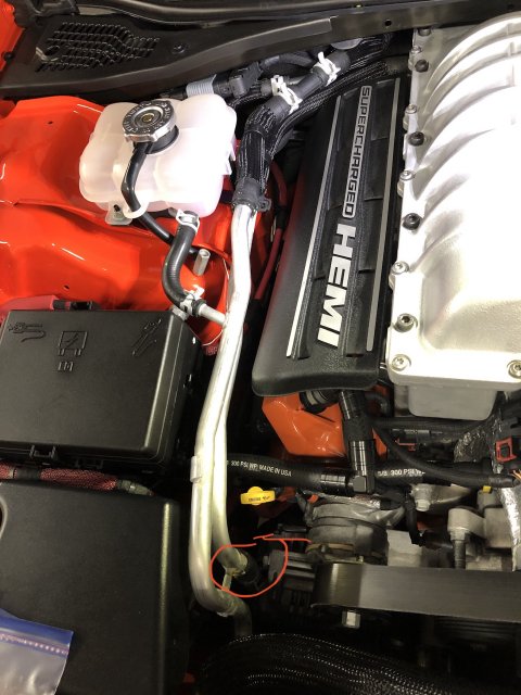

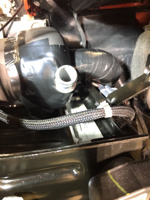

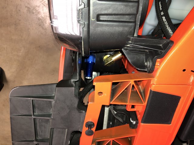

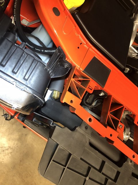

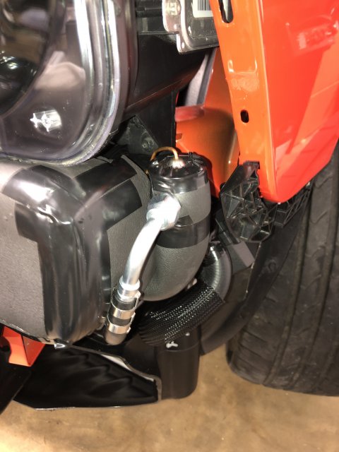

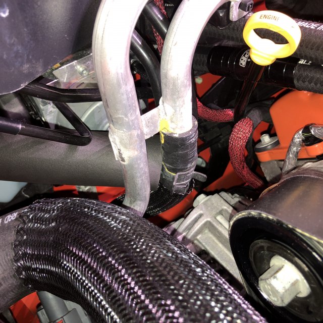

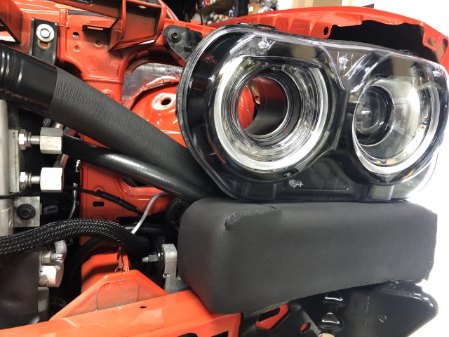

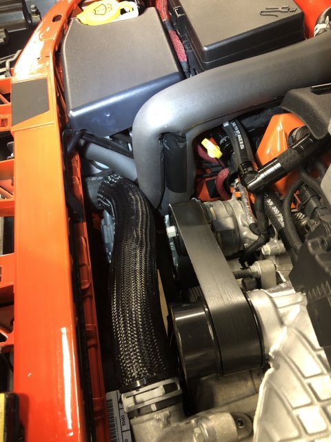

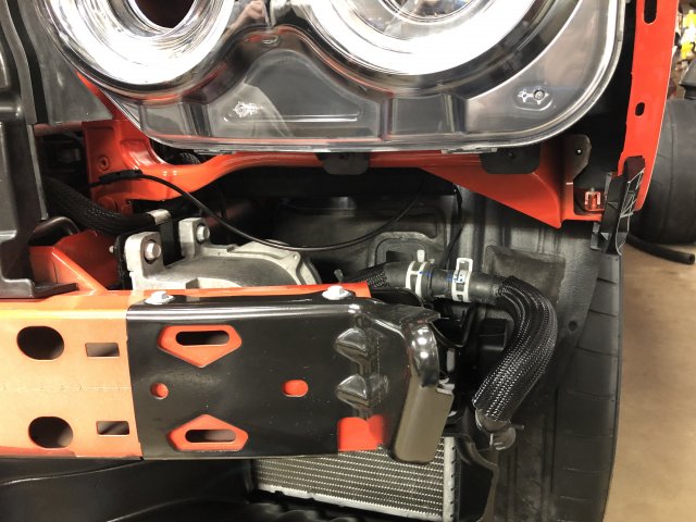

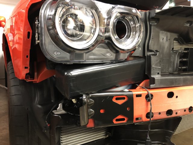

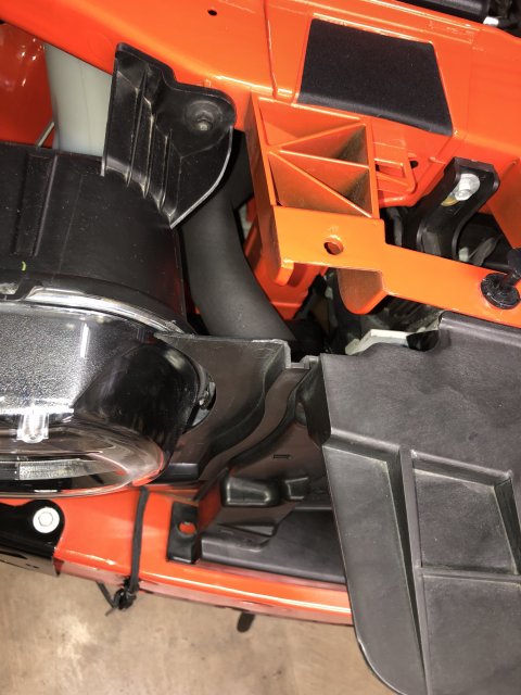

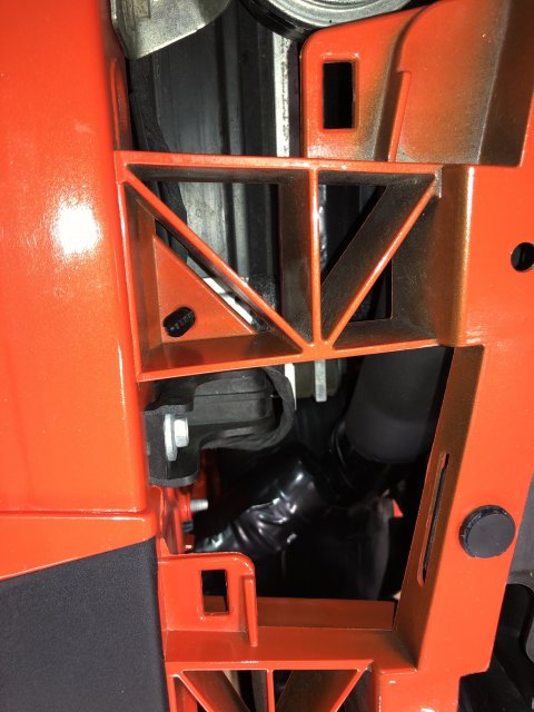

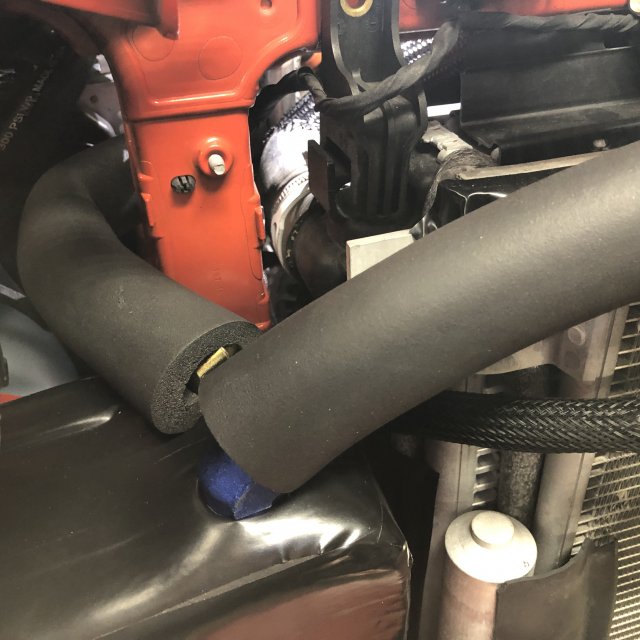

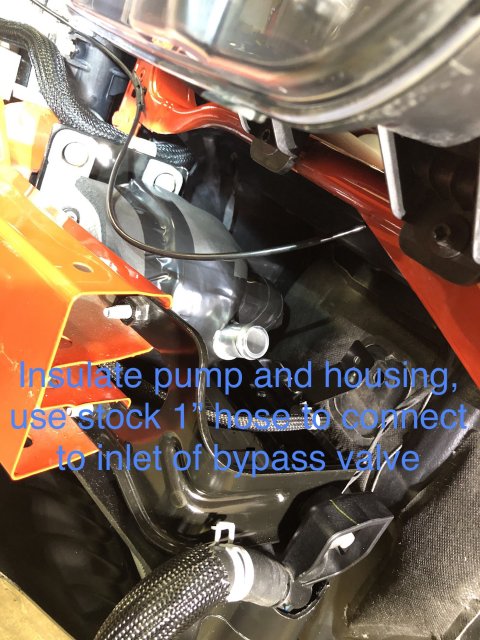

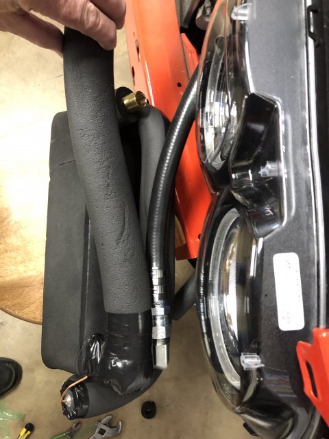

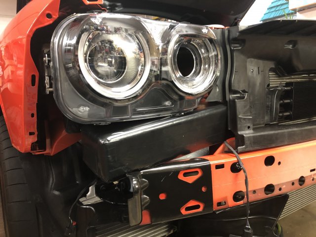

Insulating to the degree and neatness I did took easily twice as long as putting the parts together, it was a process and a toil trust me. It’s insulated like that right back to the pump inlet, pump, valve to the unit. Under the headlight and behind the number facial it all hides. Even this slick bleed Tee right under the hood latch cover.

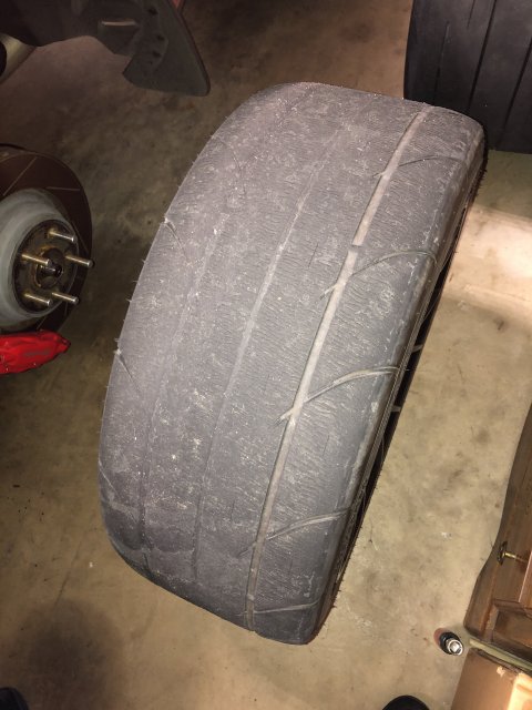

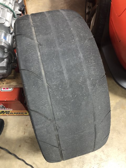

The tires afterwards

I just had to take them off that night before I could go to bed, that little rubber in 850 wheel at 39F was like asking to die. The 315 brand new Nitto 05r’s gave me a good vision to go to sleep on

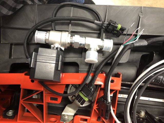

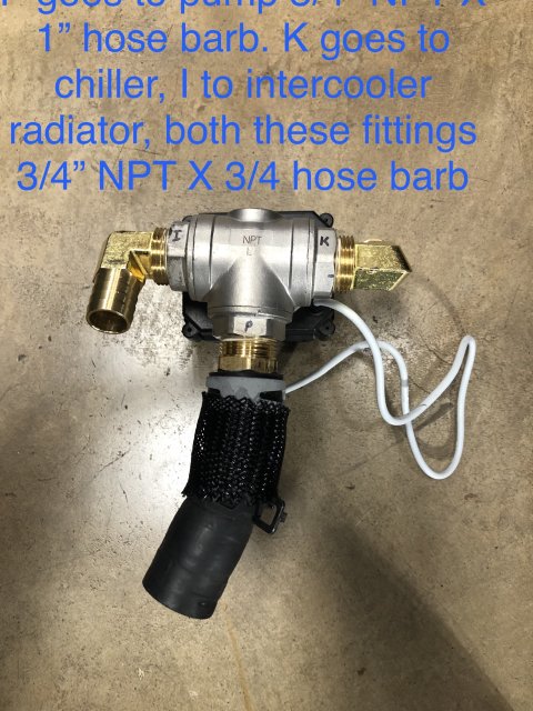

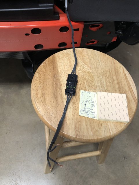

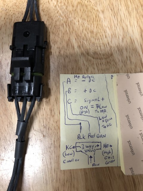

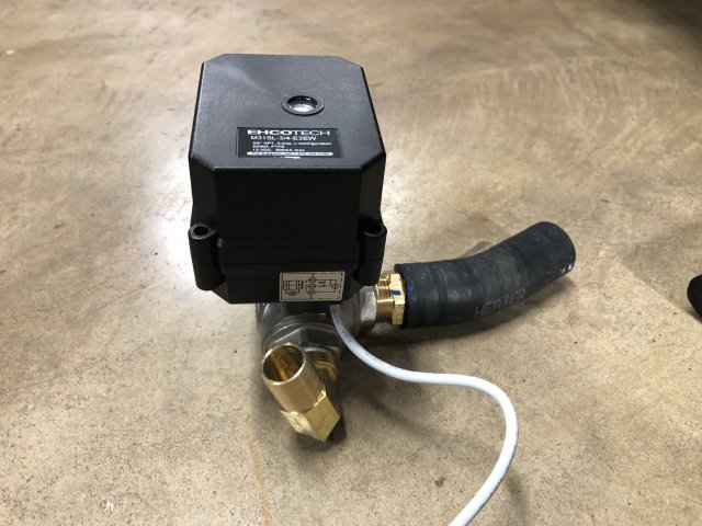

The KC idea,,, wonder whom came up with that idea a year a go??? HMMM. Wonder wo tat chiler mechanic from Florida is?? HMMM. Now question on your 3 way valve. Set up control wise. Is it in mixing mode, different tempts preferred, or diverting?? When not in operation is the valve normally open or closed for freeze protection ???
3,687
8,687
Thread Starter #29

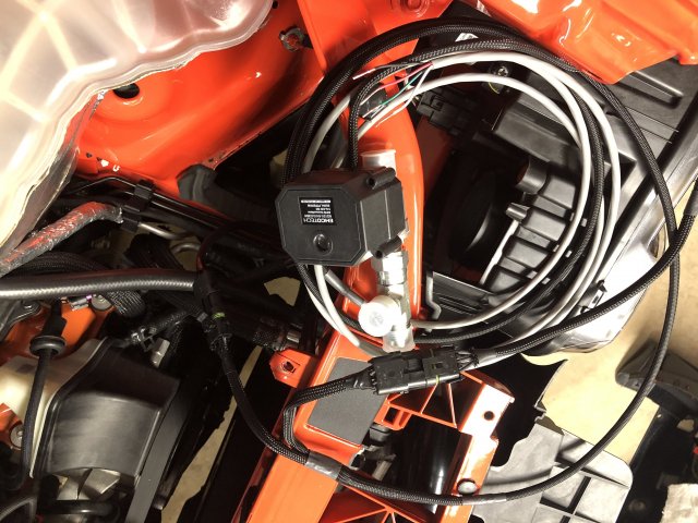

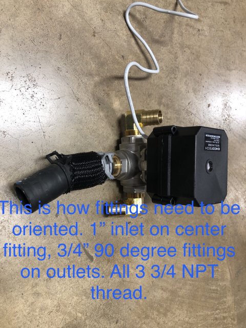

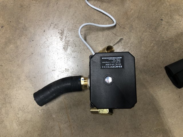

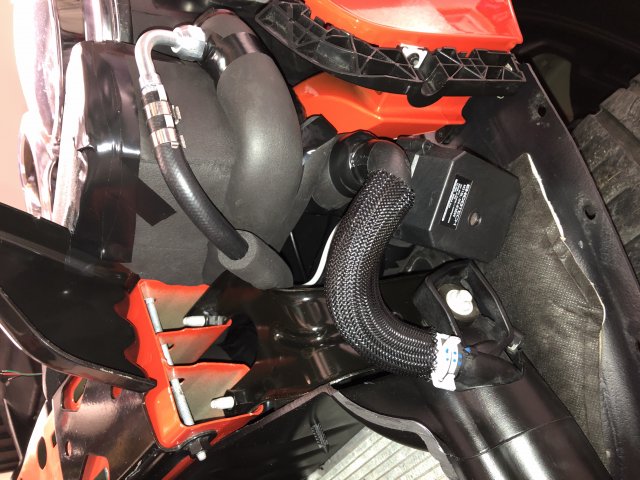

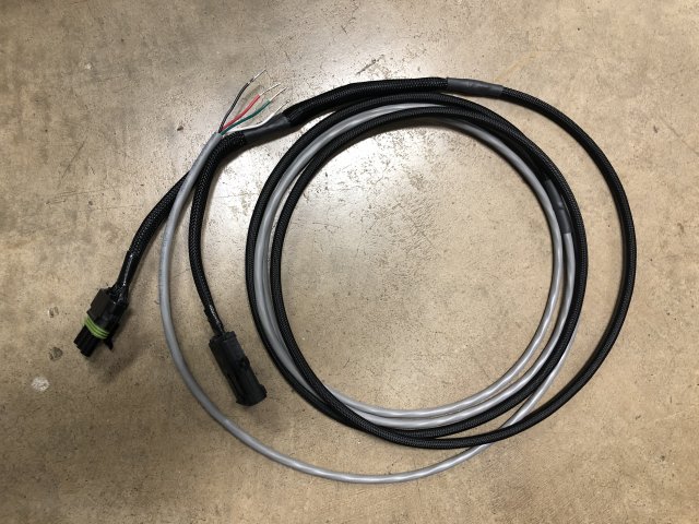

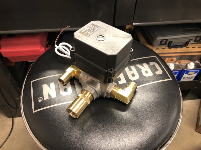

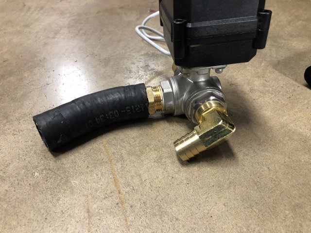

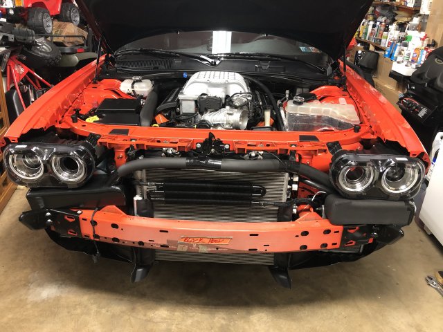

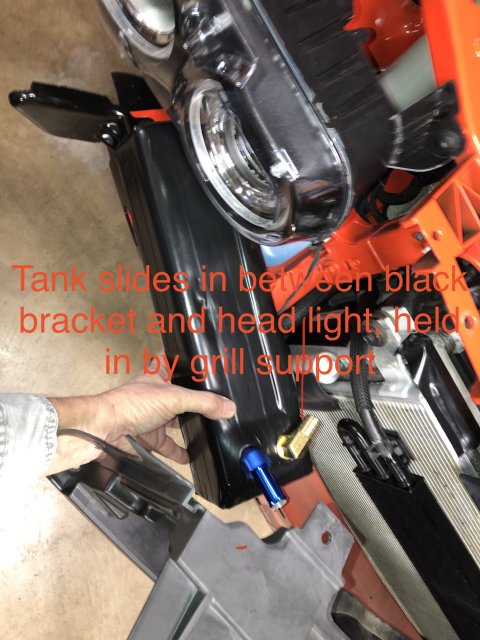

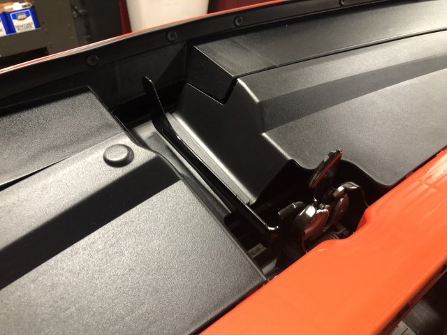

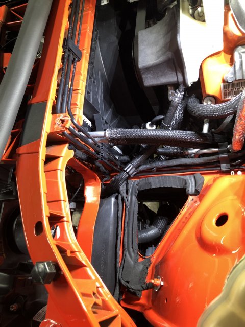

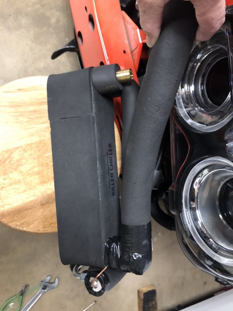

The 3 way valve is either in a position to direct flow out of the KC to the storage tank or through the radiators.

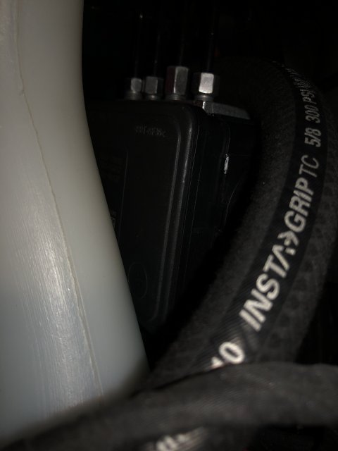

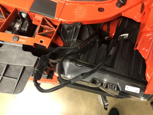

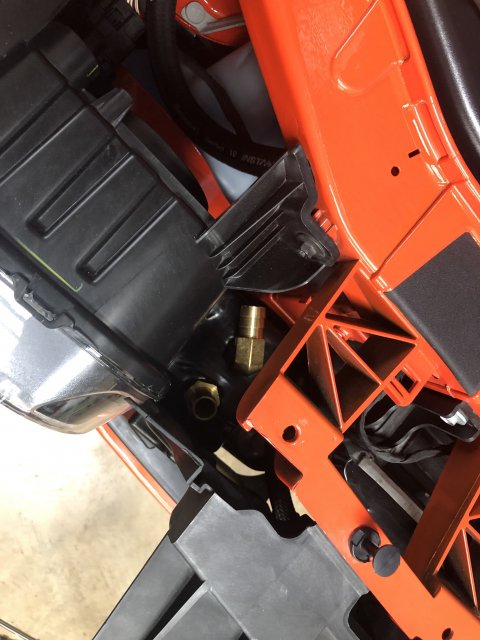

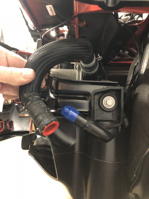

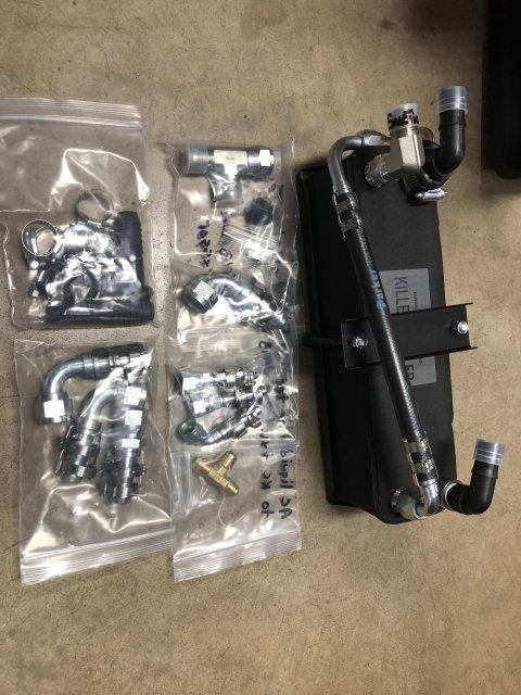

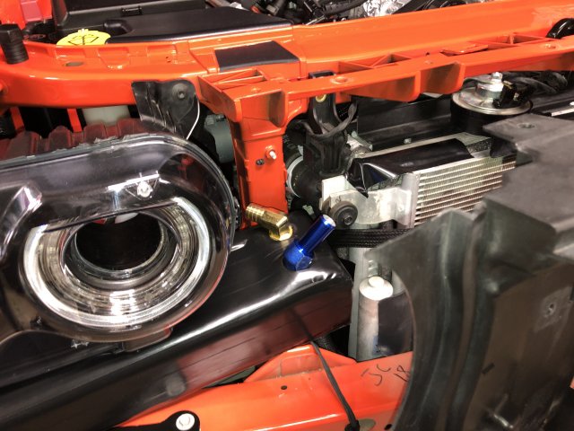

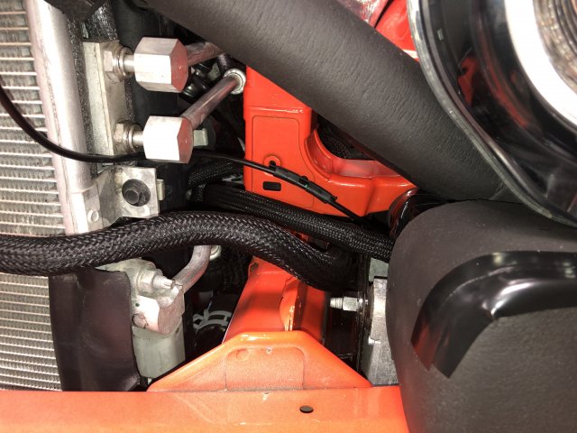

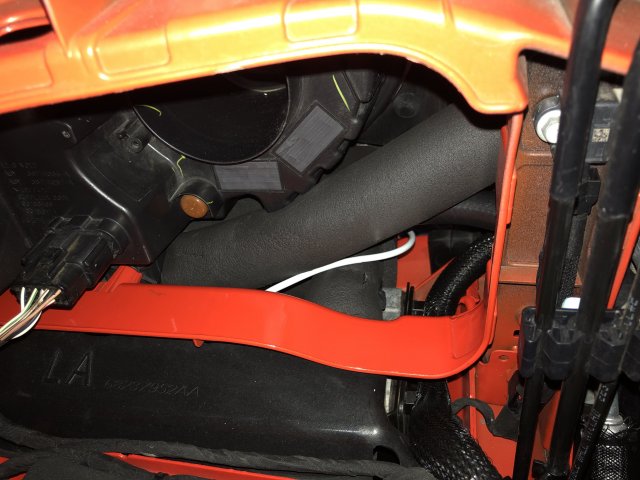

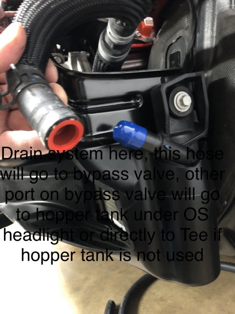

Here it is before being insulated and then picture installed 4B63D5D8-91A1-48AC-BEC2-80A5541F7D9D.jpeg 342E1714-FB39-4C49-A0BA-8B7EC01C2D01.jpeg 66273D5F-6C98-4674-9F0C-82706316AC0F.jpeg

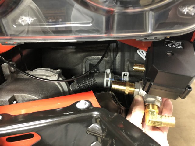

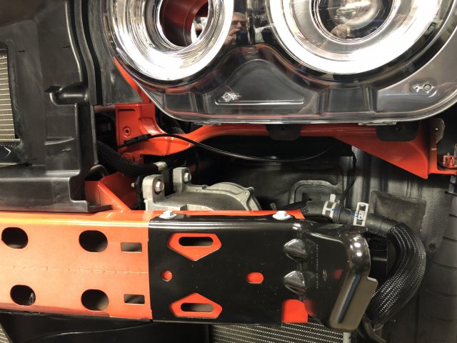

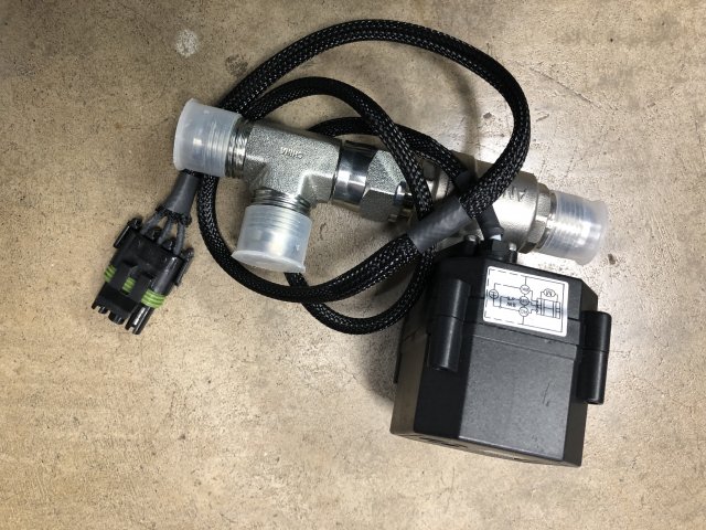

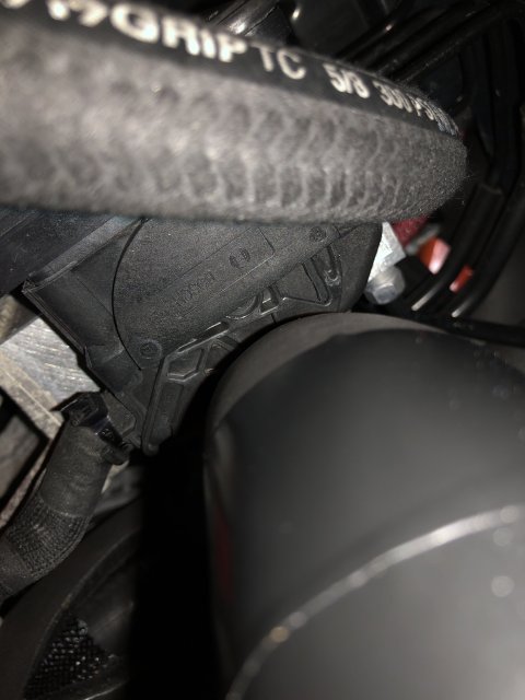

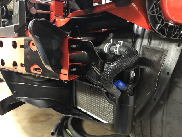

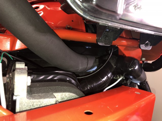

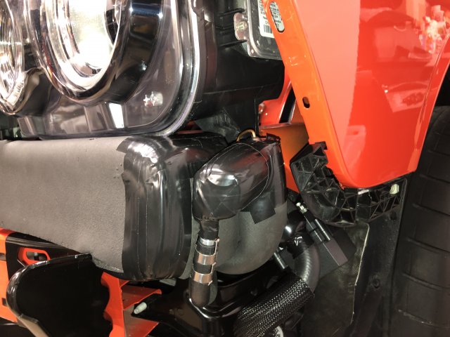

The Drag valve is another motorized valve but is just off/on and located in the suction line under the air box. I insulated it to protect it from radiant heat
73F9B06C-241F-4E76-9AAA-668BD89902A6.jpeg 0E090199-8D0A-4E55-AE09-844DB34994A2.jpeg

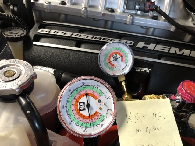

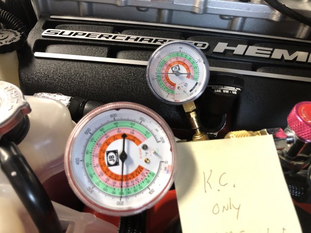

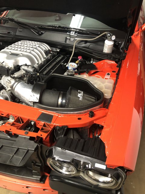

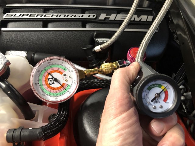

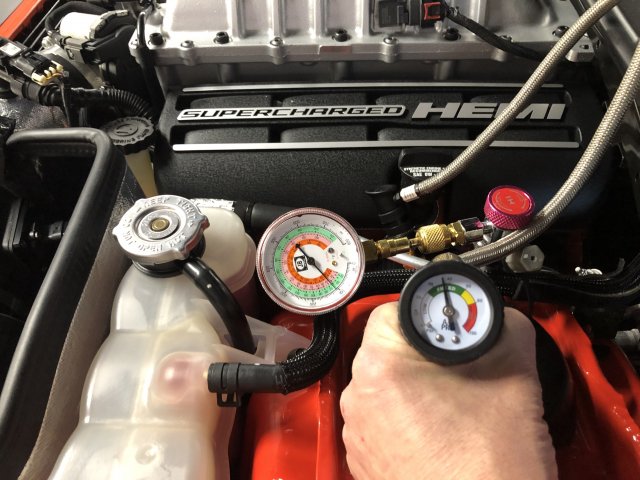

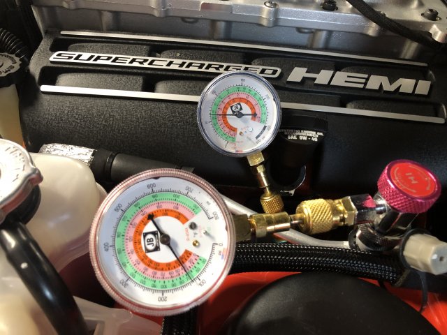

Here was the ending charge pressures after a 1 oz oil charge, 1 oz of conditioners and 4 12 oz cans of straight 100% R134a. This at about 70-75F ambient

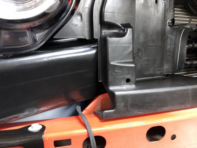

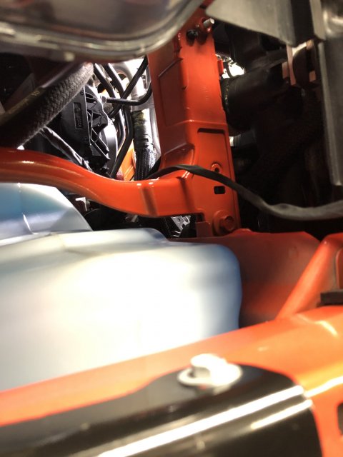

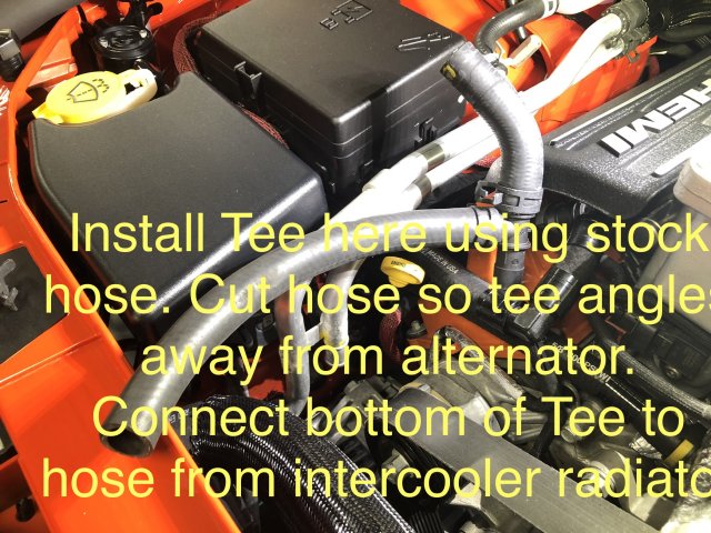

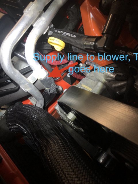

Here is a string of pictures beginning to end, I’m never going to be able to come up with an afternoon to put together a step by step instructional post. If any one has a question on a step post it to this post and I’ll answer it.
378518AB-8EE0-45C1-9543-F4B78625BCCB.jpeg B21188A0-FB65-4693-AE0F-0C1B7FC27C99.jpeg 6443F0DD-BBA1-41AA-AEE6-219672792854.jpeg 29959F25-BF67-46E3-A6B1-156E687FDED4.jpeg 344419A2-436E-4B73-A197-E20CF60B52BD.jpeg C2BA7879-C6C9-4F43-BD9F-DCF843045EC7.jpeg D76882D8-A9D7-4933-A32E-09A436B1058B.jpeg 5893EA97-1904-46C0-AC05-8C154231F9B8.jpeg F3C41C1B-1E63-40EB-9DCB-29E8BBD46768.jpeg

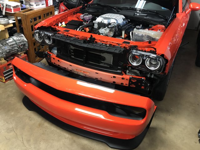

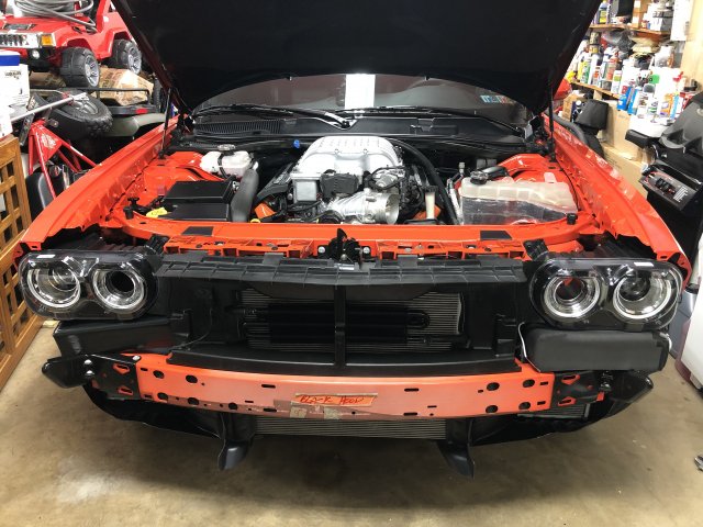

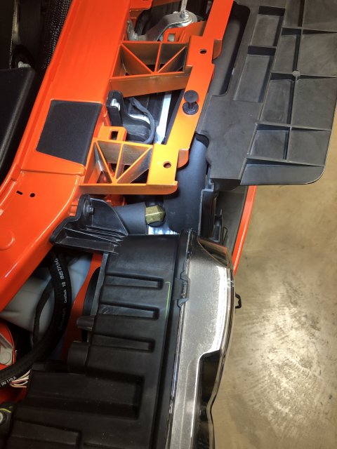

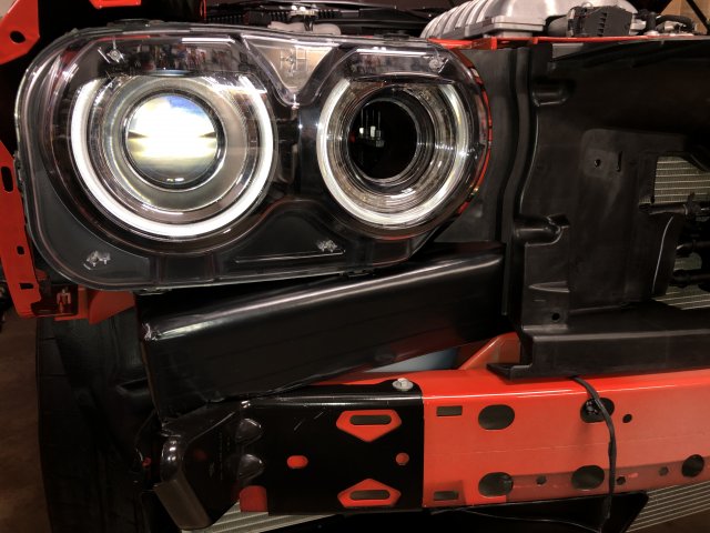

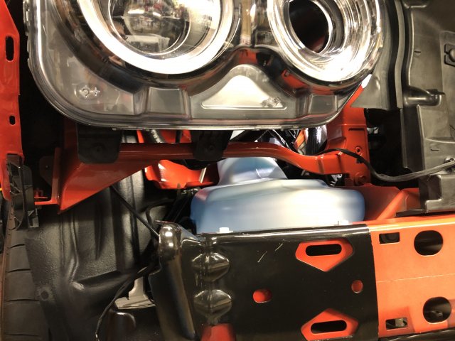

Thread Starter #32

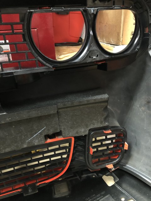

Search for a YouTube video on removing the front facial, it’s not that difficult, 30 minutes, toughest part is the 2 nuts right above each side marker light 6F29CD71-1B26-44DE-81FA-9F6962AAAFF8.jpeg 88D133F6-9A54-4BA7-AE01-003A144BB9AF.jpeg B842D655-96C6-4720-902B-432B54955C57.jpeg 147B4324-9B06-44E4-8018-3A14461467E9.jpeg E2EC0887-E95C-4F37-9360-A6D5529AF4CC.jpeg 2B0F4D6E-489C-42E4-9AEE-221C9A4F993E.jpeg 0DE5F5E5-9C2E-4548-9D6F-53B2FB499BEE.jpeg E734C264-A6E2-46DD-B709-D7B951ED3E00.jpeg 1D515DE8-3874-4127-A683-515F55575F1E.jpeg
