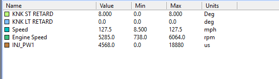

it’s spring here finally! Over winter I put in Demon Injectors, 2.85 Grip Tech, Green Filter and a 180 degree stat. Pretty basic setup on 93.
Well I did my first WOT pull today and got 8 deg of short term knock!
Injector duty cycle looked like it was 79 percent. Which is good. I was wondering how I was going to turn out running those.
The fuel I’m using is from fall but I put stable in so I was hoping it was fine. I guess I’m going to drain fuel tomorrow and hope that’s it.
Stay tuned. Hope it’s worked out by the first Saturday in April when the track opens.

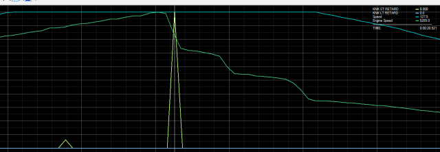

Edit:
I looked at the log again this morning. The chart is confusing because speed is messed up the blue line. I don't think speed picked up again until I dropped below 127mph. But looking at rpm (Green) it looks like the knock (yellow) happened right after I let off. There is a small amount of knock it looks like in 4th but it's only .5.

OP,
Any video of your knock? Able to tell it only by data log or could you hear it as well?

Only by datalog. Speed was higher than that I think for what ever reason the log stopped reading at 127mph and just straight lined.

Well glad I just took another look at the log this morning. The chart is confusing because speed messed up the blue line. I dont think speed picked up again until i dropped below 127mph. But looking at rpm (Green) it looks like the knock (yellow) happened right after I let off. There is a small amount of knock it looks like in 4th but it's only .5.

Try new gas and try again.
Sometimes modifications cause false knock. Rule out it isn’t real first.

Since I have an 18 I’m going to try and drain the fuel out of the port on the rail today. I tried to siphon it from the tank last night didn’t work out for me. I kind of figured it wouldn’t.
