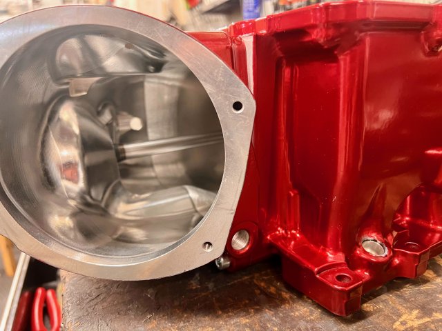

Greg from Kong just sent me these photos. Pretty psyched. 3.8 Billet version ported. Should ship in a few days. BES Racing just called me friday and told me my Aluminum 430ci Stroker/Thitec headed motor is on the way!
So psyched! Been a year long build smh. Been waiting 10 months for the motor. 130mm TB just came in as well with 2150 injectors and (3) JMS boost a pumps. She's gonna be thirsty.....:giggle: Guys are telling me they are making 1500 whp with this similar combo. Idn we will see I guess. Married to E85 now...... Were inseparable cause I cant run 93 octane with those injectors unfortunately.

Very nice. I believe all the 3.8s are ported
