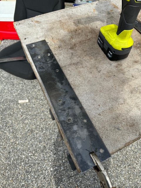

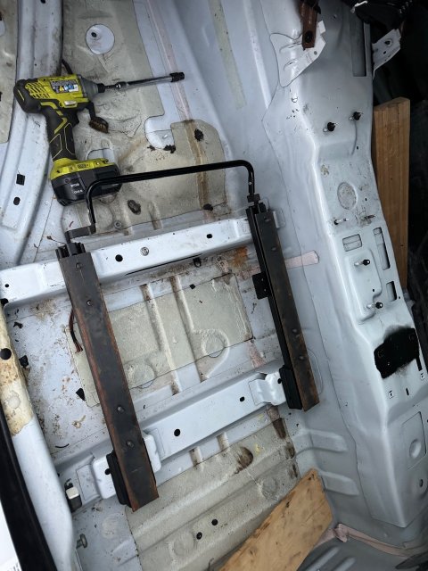

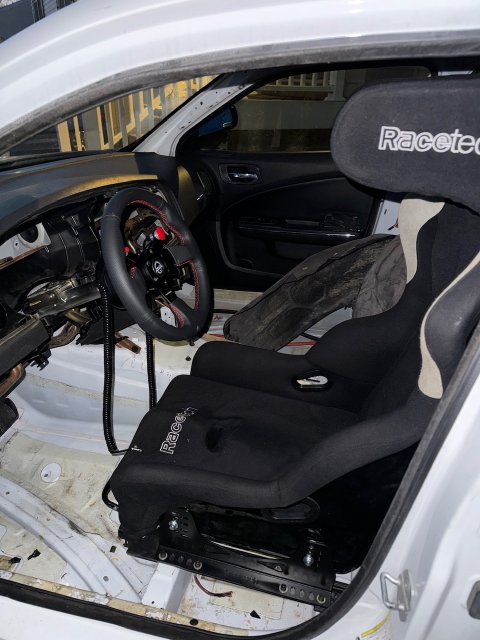

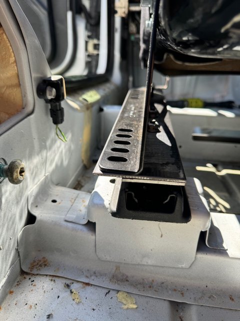

Started with 2”x18”x1/8” steel drilled to fit on the stock sliders.
as you can see the brackets overhang a lot, on the shelf added a 3”x18”x1/8” overhang for them to bolt to.
doing a test for height, had to lower the seat as I dont know where the bars will land yet, also helps me figure out placement of the th400 shifter finally
have to run the vacuum again. Todo: remove seat final time. Do final welds of the bars together. Paint them and final assembly.

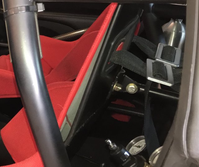

It’s possible that a strict NHRA tech might have an issue with using a slider on a race seat. One of the things I have actually had them check is the required brace connecting the back of the seat to the roll cage. That will make the seat fixed. I can only find one picture where you can see it with my Kirkey. IMG_4951.jpeg

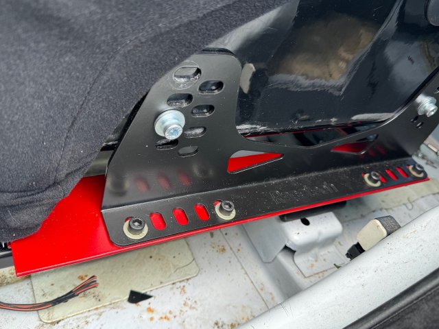

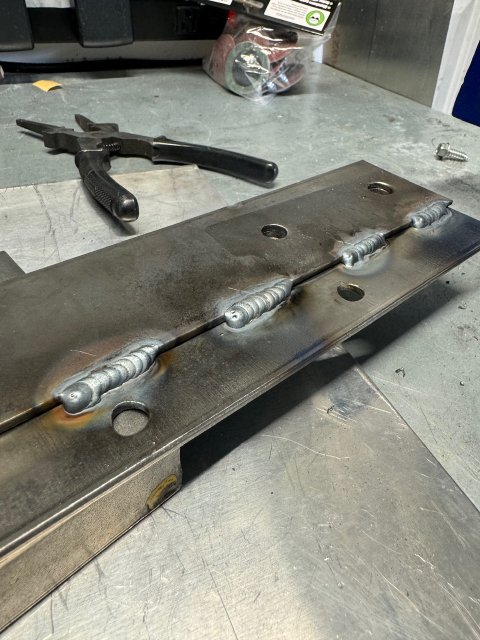

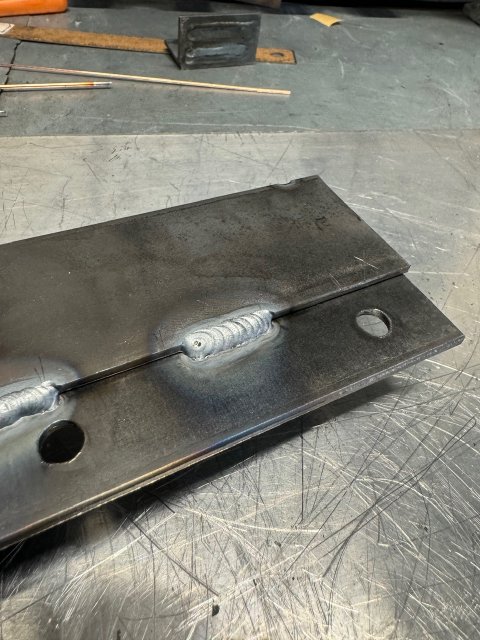

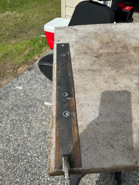

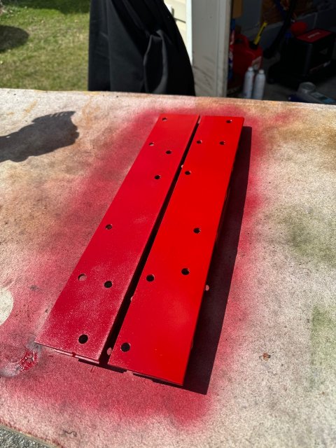

Finished products! Didnt weld the front a d back edges as there are also welds on the backside and the lap joints.

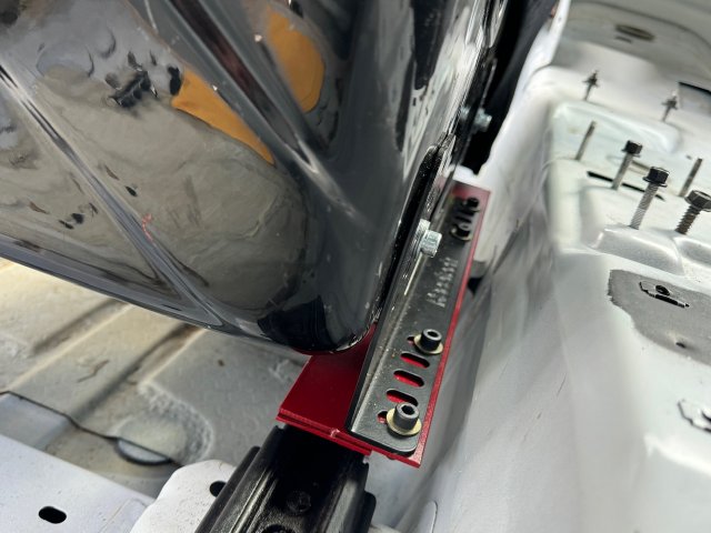

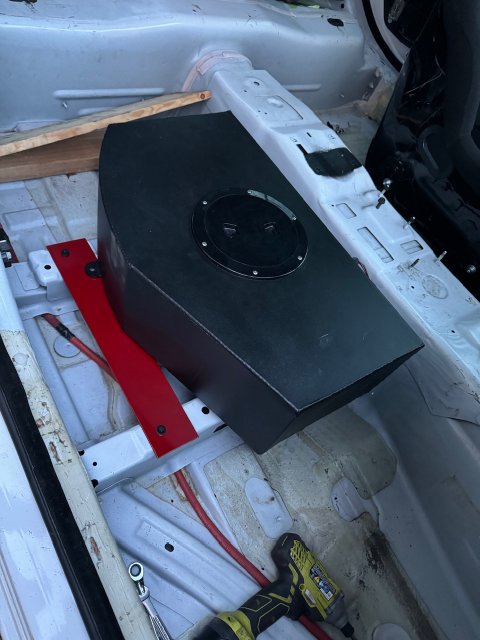

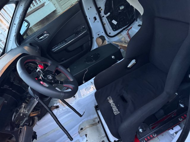

I may have had too much fun with the red paint this weekend.

View attachment 132869 View attachment 132870
dirty… View attachment 132871
The more I practice, the better ill get View attachment 132873
120 amps makes even steel want to warp View attachment 132874
First coat of many! View attachment 132875 View attachment 132876
Looking good! Overkill for a cage, I bet you could weld one up and get it carted no problem

That’s the ice box designed to fit in the trunk of a challenger. I would sell it and get a regular one, can put any basic one in the passenger seat and make some $$
You buying it? Otherwise it will stay put.
8,508
7,437
Nope. They’re $500 though, a regular one is like $200. That’s all

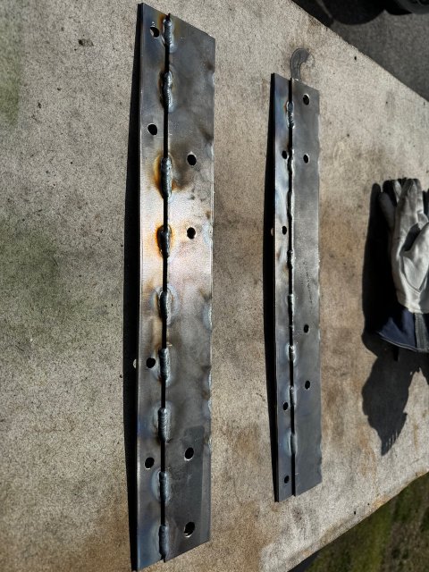

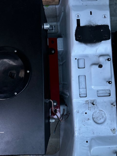

Had a chance to get this all welded up and in the car. It ain’t easy. Had my weld settings all wrong and was struggling till I looked at the damn machine after getting cold welds. Had to redo them all… 🥲

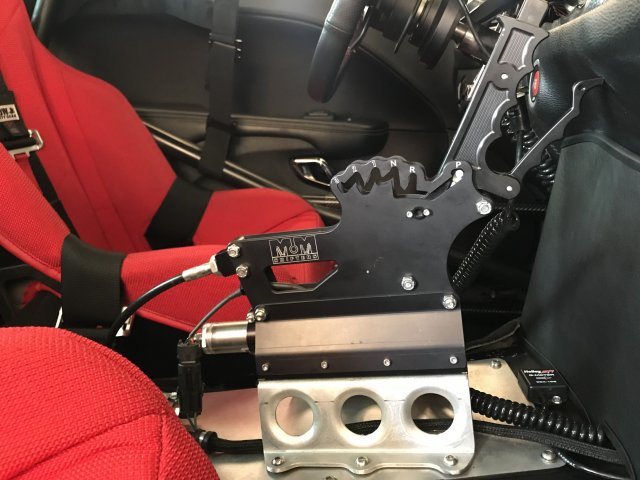

Good job on learning to do stuff yourself 👍🏼. I welded full time for eight years to pay the bills when I was first on my own. We make these… IMG_4961.jpeg

I can't remember if you are Co2 or air assisted in shifting? Do you not touch the shifter at all during a pass. Those mounts are a beauty. I need to learn this skill and the more practice I put in the better I'll get.
Good job on learning to do stuff yourself 👍🏼. I welded full time for eight years to pay the bills when I was first on my own. We make these… View attachment 133553
