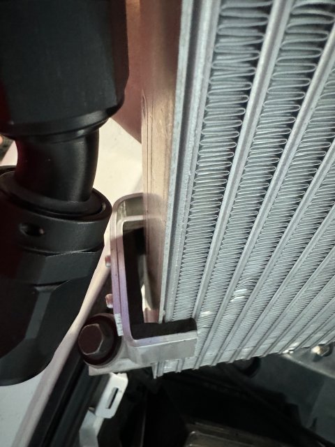

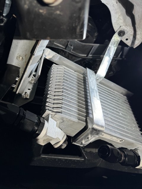

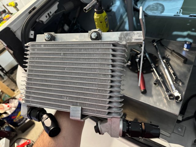

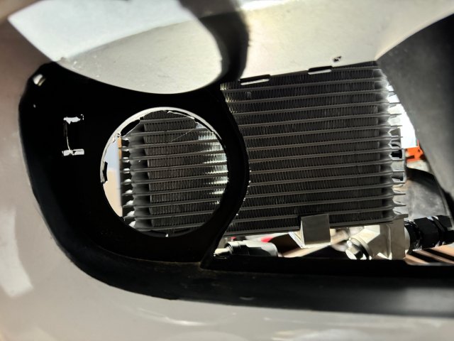

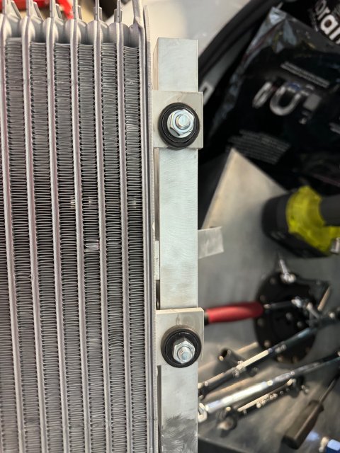

peekaboo oil cooler, i see you! Have to trim the bumper
IMG_3732.jpeg IMG_3730.jpeg IMG_3729.jpeg IMG_3728.jpeg IMG_3727.jpeg IMG_3726.jpeg IMG_3725.jpeg IMG_3724.jpeg
its pretty solid when bolted in. Does have some flex but thats how it be sometimes

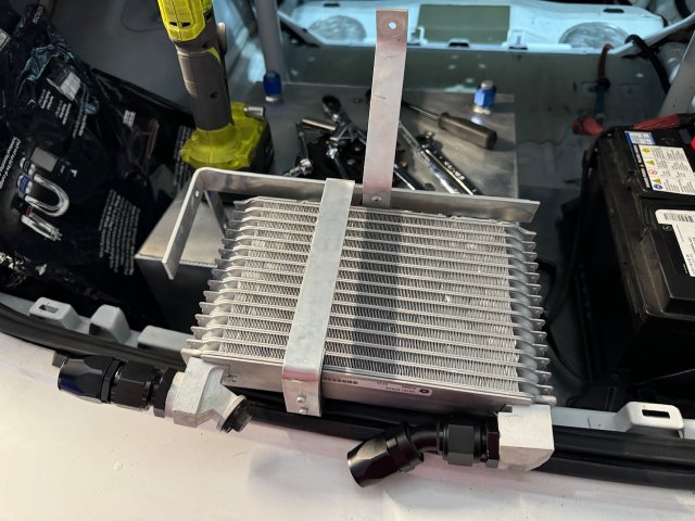

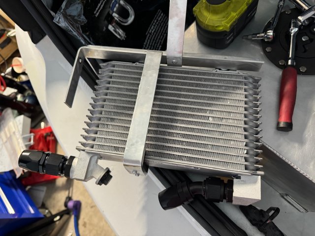

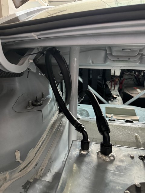

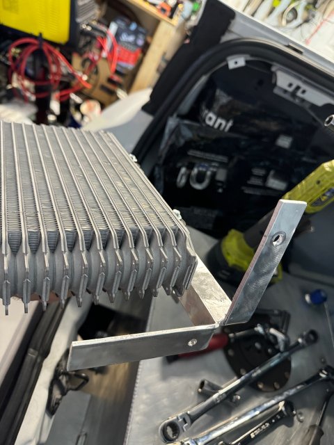

Lots of progress.

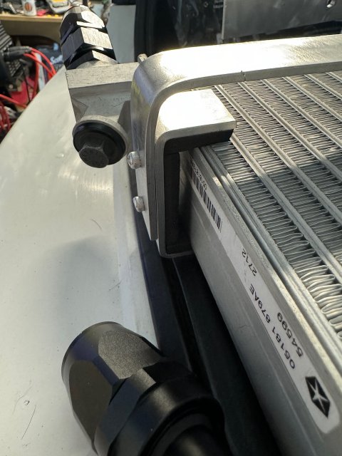

Had to seal trans cooler before starting engine, otherwise would spit fluid everywhere.
Transmission Cooler pt. 1
Transmission cooler pt. 2

Please make sure trans cooler lines are iron clad

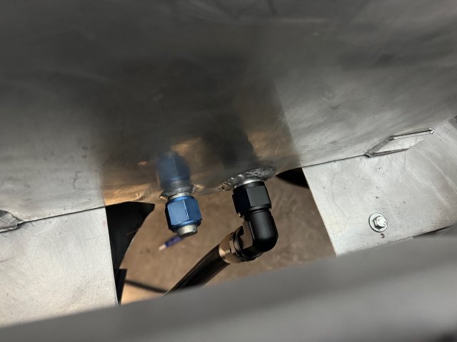

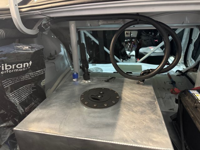

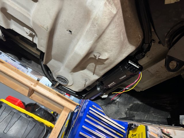

I could not find a better routing solution with a gravity fed pump. However, I will be building a shield around the pump as it is very close to the tire.

I have a video going up later today. @Marc W She is sitting pretty!

Good idea on the fuel pump shield. 👍🏼👍🏼

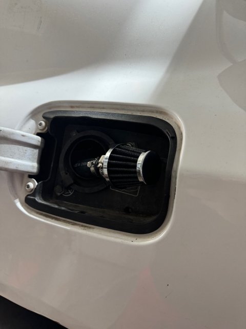

Is the vent going to be outside? Do you have a check valve in case the car flips?
4,087
10,233
Thread Starter #552
If the car flips i have bigger problems.
8,510
7,427
Read my mind lol and no bad ju-ju here was just wondering, thought check valve was mandatory for vent
No you’re right. Quick fix.

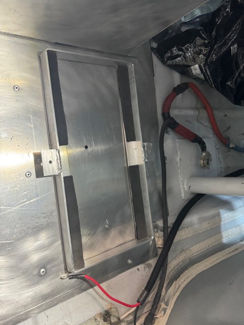

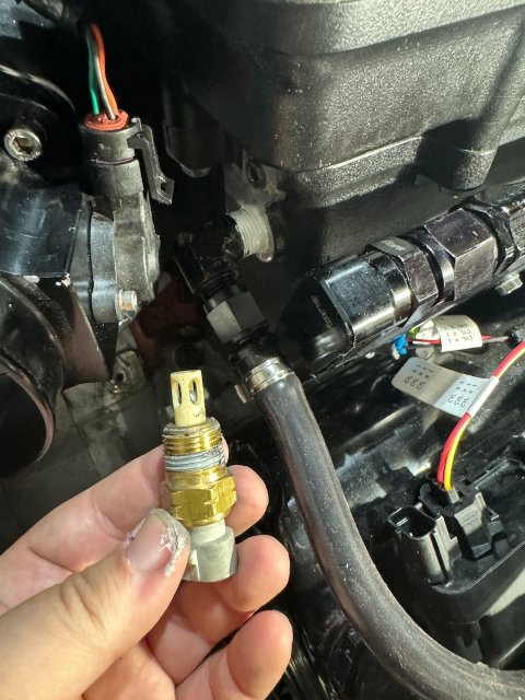

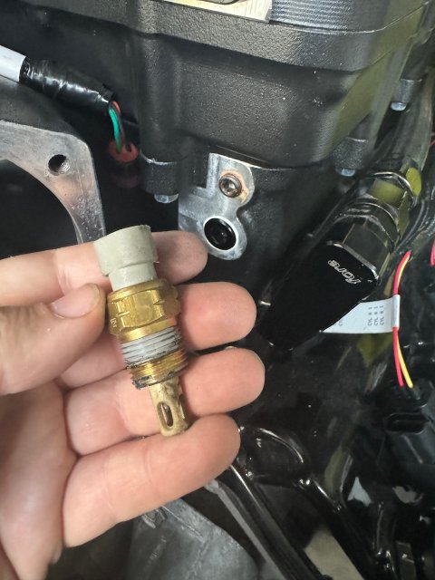

Removed this unusable sensor and added a vacuum line to the master cylinder IMG_3865.jpeg IMG_3867.jpeg
