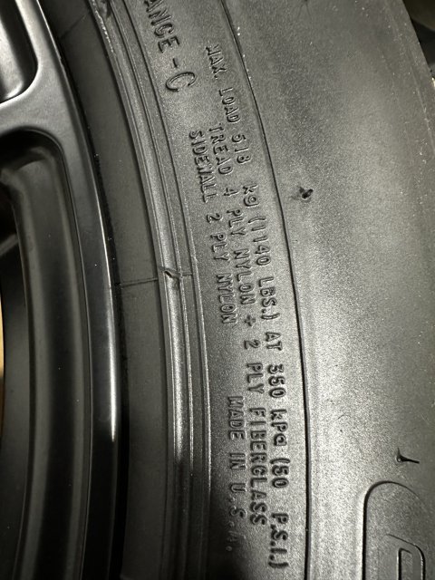

They’re a little heavier than I remember with wheel aired up to 50 psi and custom hub bore rings in them
8,508
7,422
37.4 lbs with wheel, max load rating is 1140 lbs at 50 psi. These were made in 2022

I have front sway bar and end links out, passenger seat out, rear seat delete, and Kirkey aluminum drivers seat. Still probably over the 1140 lbs on driver side, most of the weight is in the front of the car. But would like to see someone with scales weigh each side of the car
