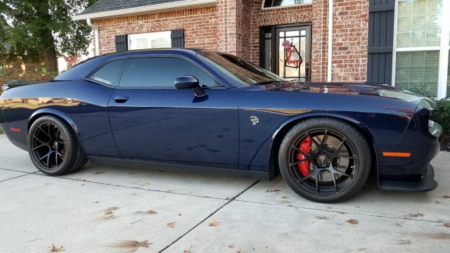

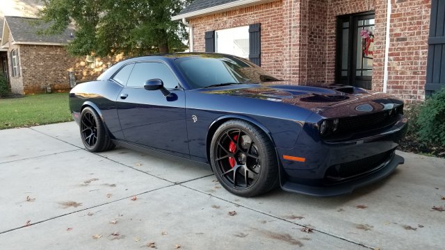

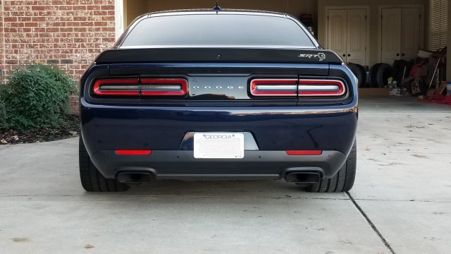

BC Forged RS41 wheels. 20x10.5 in the front and 20x11.5 in the rear. These pictures were taken before the BMR adjustable suspension was installed so in the rear picture you can see the camber is off on both rear tires but the right rear was the worst, it has now been adjusted and camber is within factory spec.

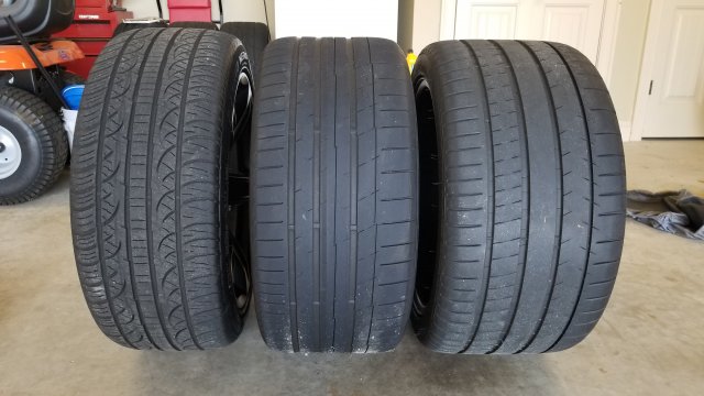

I've posted this pic several times before but here's the difference between a stock 275/40/20 Pirelli All Season, 305/35/20 Continental ExtremeContact Sport, and 335/30/20 Michelin Pilot Super Sport. I run the 335/30/20 on the rear and a 295/35/20 on the front which isn't pictured here.

I've posted this pic several times before but here's the difference between a stock 275/40/20 Pirelli All Season, 315/35/20 Continental ExtremeContact Sport, and 335/30/20 Michelin Pilot Super Sport. I run the 335/30/20 on the rear and a 295/35/20 on the front which isn't pictured here.

Ya know it's funny. The difference between 305 to 315 is not that dramatic. But the diff between the 315 to 335 is huge. That thing is monsterous.
I misspoke above, the Continental in the middle is a 305/35/20, not a 315/35/20. My fault, I will go fix the original post. My brain was thinking 315/35 because that's what we run on my wife's Hellcat Charger on the rear. These tires were 305/35's on the back of my Challenger Hellcat. The tire width is really noticeable about every 30mm in width.

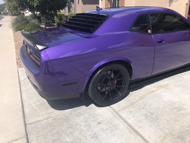

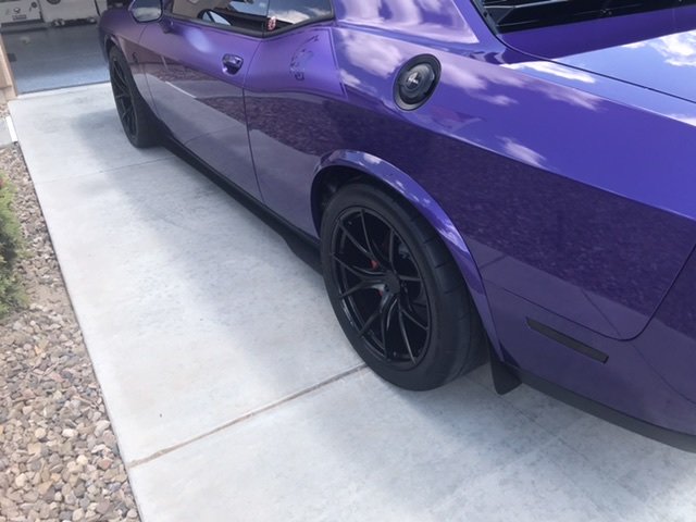

Ok, got them installed. It took a little Afro Engineering to make the ZL1 rock guards work. There was 0C772935-7588-4465-83D4-777E9C727BA4.jpeg 3FB2C280-59F7-4BBF-B938-EEAF37274F97.jpeg
some interference at top bolt and Lil Devils. Easy fix just removed a little material.

Looks perfect

Ok, got them installed. It took a little Afro Engineering to make the ZL1 rock guards work. There was View attachment 14697 View attachment 14698
Yea, you have to do a little modification to make the ZL1 splash guards work but nothing crazy.
