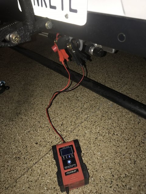

Well crap. Weather's been crap and I've not driven GoManGo in about 6 weeks. Went out to the garage to check it and the Arc Angel battery seems to have lost enough charge that it won't power the car. DMM says 11.38V. I don't think you can jump a L-ION battery.
What do I need, a trickle charger for L-ION to get it back up to snuff?

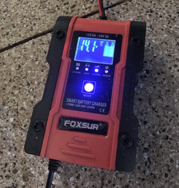

I ended up getting the NOCO 5 charger. Amazingly it said if I ordered today I'd get it today and sure enough I did. It's charging the battery now although I think it's gonna take about 5 hours to get it full. Pretty happy with the little unit. Super compact and nice connectors, but I do wish it had the readout on it for voltage, temp, etc. 13,000 amazon reviews said it was great though.
Got this one: https://amzn.to/3WFIuBu

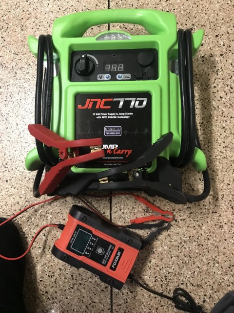

Yes you do. This is the one I’ve had for years and it works great. image.jpg

I have the old (going on 4years) Arc Angel. I found that while it was spinning the motor on startup, it wouldn’t fire. That turned out to be the EFI coil packs. They require a minimum of 11 volts or they won’t fire. If the battery didn’t have a full fresh charge, then turning it over was dragging the battery down below that threshold. Those coils are outta here so that issue won’t be a problem any longer. I have a self contained jump starter that is for use at the track. Hooked that up and it fired immediately. So no issues with jumping (so far 🫣). I also have one of the NHRA battery disconnects that help when the car sits. BEE8DC85-023E-4D21-B312-165071EC6AF3.jpeg
