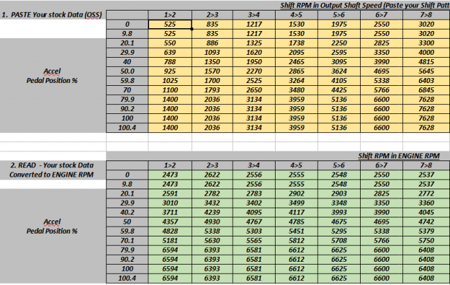

@Speedy! thank you! 3.09 gears do that, feel like cheating, lol... I'm having problems with the trans though. It is banging off rev limiters in random spots. Can't tell if wheel slip or I'm not giving it enough line pressure. All logs attached. I was looking at the tune that was written and it seemed like it was corrupted. So then I re-wrote it to where it was on the MHSH event and it was still banging. Considering it is great air, she's eating maybe I need to command the shifts earler. Test N' Tune, Test N' Tune!

Congrats on your PB's that's awesome. At one point you were shifting too high, did you lower it & where is your shifts at now ?

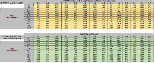

So some historical background, these were the shifts provided by a tuner that had me banging off the rev limiters hard in 1st, 2nd, etc...
These values as reported in a post that @Speedy! commented on showed that the TB was closing because I was hitting the rev limiter, hard. These are my current values:
I don't have any test n' tunes coming up and I have the MHSH coming up soon. I did notice that the Tune that I flashed was sort of corrupted. It had values in them that I did not put in there. Don't know if it happened in the copy from my desktop to my car's laptop but from now on I've set the master to be the laptop and will only write tunes on that. While at the track I put the values above in the transTCM and went to get more data.
TCM RPM Limit: 7560
Max Torque Limit, Slip: 800ft-lbs

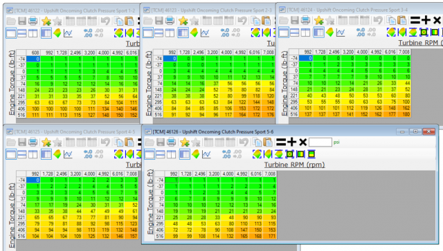

Oncomming clutch pressures:
If we are going to put this in context, please use run 6 for any exploration. That is the only run I can guarantee the values in the spreadsheet were actually in use.

On mine I didn't mess with the clutch pressures. There's a different table for shift pressure.

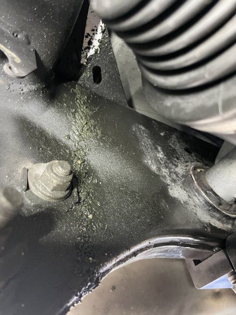

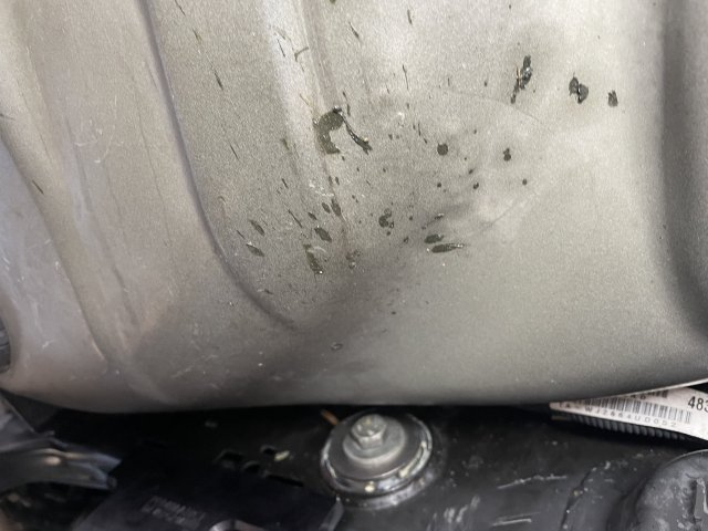

Went with solid mounts as I had two sets of dodge urethane/hydraulic mounts leak. Hot shafted by dealership twice on it too! Working on the rev past 6500 part. Wasnt my doing, reverted TCM tune to stock and seeing where it shifts at playing with data to try and get it as close to possible to 6500 safe

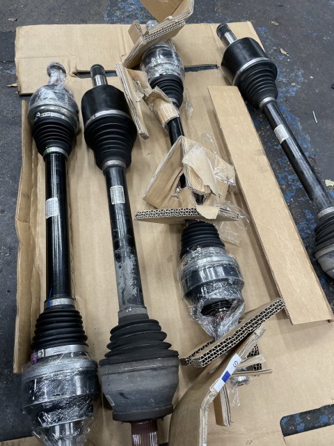

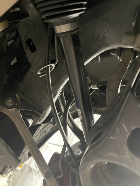

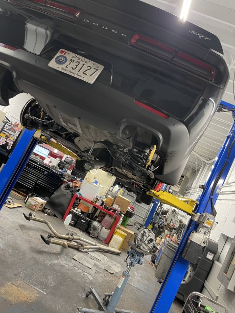

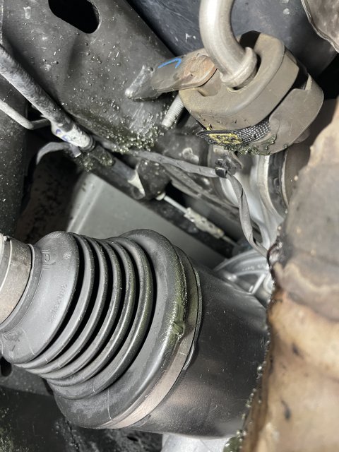

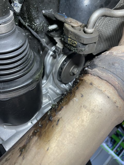

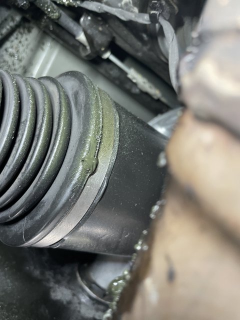

Axles finally went. Was getting major vibrations on the highway last night. During lunch got it up on the quickjacks and inspected. Good thing I have @16GoManGoHC2 redeye/demon axles. Trying to get lift time for tonight.
View attachment 57558 View attachment 57559 View attachment 57560 View attachment 57561 View attachment 57562
Ah on the axles . At least you an upgrade ready to go .
I know just trying to find lift time. Right before the mhsh, FML.
