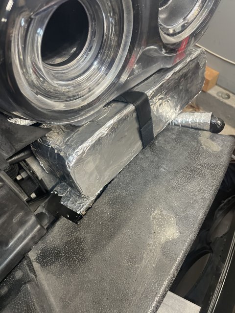

Using up that foil tape?? Fiberglass underneath??. Armaflex may work better but hard to deal with if not used to the glue. Glue is 25/50 ratings.
No fiberglas under the tape, not needed. Armaflex was used on the main cross hose from KC out to coolant tank. Used the self sealing armaflex. Everything else is wrapped in Vibrant heat shield.
Good job. You know they make the Armacell for hot and cold services now. I used some stuff in Orlando on a chiller that is good for 1,200 degrees. Even the glue was rated that high. One end was 42 the other was 1,100. Whata difference it made when we finished. Took 3 men 3 months to do this damn machine. The job looks good and the right materials. You did your home work.

Car is back on the road. For final bumper fit I had to remove the velconstrap as it interfered. You will have to trim a little styrofoam. The lip that rest on the cross member.

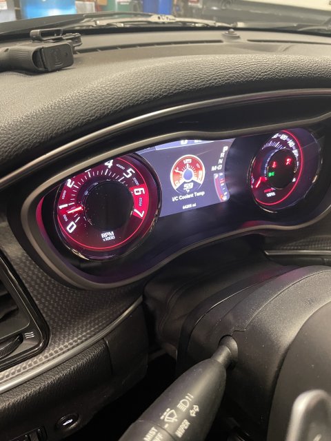

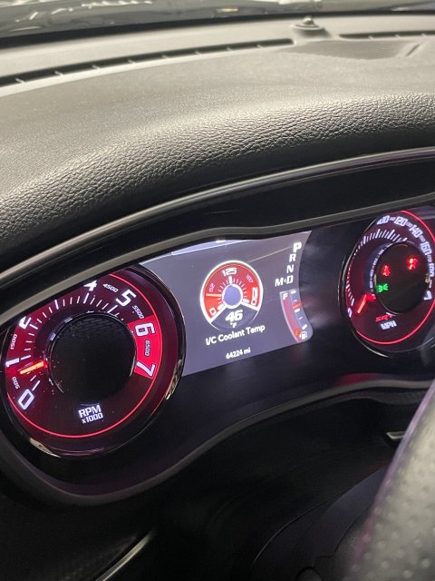

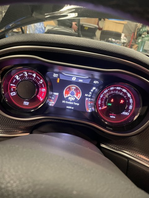

After refilling refrigerant, she was at 100 degrees, within two minutes got to 59 degrees. We had more air bubbles come out after switching the valve a few times. Drove on the way home. Super cold, as cold as the refrigerant would go. Drove home with max ac just to push it.
51C5F785-F913-4545-BE8D-4FE87103DE96.jpeg F04FC7F8-F5D1-4AAE-A1E4-086E59DB4A51.jpeg 887C6068-8905-4963-A778-526DBB3D2C82.jpeg A37E7B58-47C6-465B-BE81-C6348728C0D1.jpeg
ignore the glock (its my carry piece), we would threaten the ac machine with it periodically if it wouldnt refill it 🤣
just at idle it dropped it 40* thats impressive as hell!
That is great. Congrats. I was going to ask you the other day, if with the mods. If you thought you may need a air separators or eliminator?? Just until the bubbles go away then take em out or leave 1 in. Not very big. 3/8 brass screwed into a fitting.

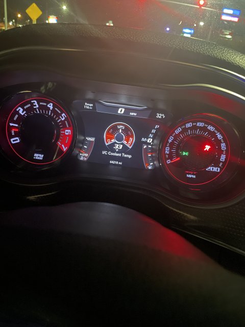

Today at idle with more bubles out it got it down to the 40s with ease. On the way home last night I popped P0EA7. Thought I blew up the pump. No sir, that fluid is still circulating like a champ.
3,795
8,986
Are you running straight water in it or do you have some antifreeze in it? It needs a 30% solution of antifreeze because it’s monitoring the current of the pump motor and if it doesn’t see the proper resistance to spin the impeller (load ) it thinks it’s running dry or it passed an air bubble that’s what the code is meaning something was odd with the pump current

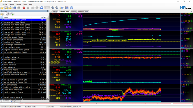

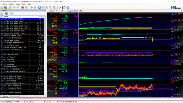

I'm still doing testing and trying to get as much data as possible. The car idled for 2:48 in this first screenshot.
Notice IAT sensors. TL;DR b1s1 is on intake, b1s2 is on snout passed throttle body, b1s3 is on the lid. All higher than ambient as the car is starting to heat up. Take note of the Charge Air Cooler sensors, those are post the bricks, one is in the front and one is in the rear of the super charger. Fast forward to idle still, car has been on for a hot minute, 7:25s in...
As the super charger has gotten hot, the air temps average out to 68.6 still, which means the KillerChiller is doing it's job as the post brick temperature is cool going into the engine. Still going to test and look forward to hitting the track tomorrow night. Also the KC frosted up on the outside, it was getting stupid cold.
7,490
19,689
Obviously with the car moving that'll be greatly reduced.

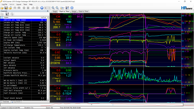

So I did not have a great time at the track. The Killer Chiller didn't do shit to stop IATs from going sky high. So there are a couple of things I'm having issues with. The first being the location of the drag valve. With this in the location that it is currently I cannot get either the stock HC air box or the jlt in. I thought by running without a surrounding or enclosed airbox it would be okay. Boy was I wrong. On a run... 200* F air charge temperature... like wtf how... my boost is also out of control ~20 PSI in fifth gear... like I've never see boost like that before.
sS
So I'm at an impasse, I can't relocate the drag valve like @16GoManGoHC2 did cause oddly my transmission lines are in the way and I can't get my stock Hellcat box back in. I can't believe how much of a difference an enclosed or partitioned air box can make. I may have the system evacuated again so I can maybe point the valve down and see what box I can get to fit in there. I'm very sad that I can get cooler temperatures without the system.

Your issue probably isn't related to having a non-sealed airbox. There's a ton of non-boxed aftermarket intakes running around out there with the factory cooling setup that don't experience anything like what you are.
It helps to understand theory of operation in this case with several pieces at play.
The vast majority of the heat that you're seeing is generated within the blower itself when that air gets compressed into boost. That would be your BSS3 temp at 266F. Then it passes through the intercooler and that heat is transferred into the fluid depending on the temp of that fluid. With the amount of heat that gets generated and transferred in, that fluid will heat up super quick so it needs to be replaced by fluid that isn't heated (you need good flow for that). With a stock system, this process of heat transfer, flow, and heat extraction through the secondary and primary heat exchangers is able to bring those 266F (or more!) temps back down to a reasonable 130F-160F range.
Likely what's happening is that you have a flow issue. The fluid isn't getting replaced by cooler fluid fast enough in the intercooler bricks. It heats up, stays hot, and the hotter the fluid, the less heat it'll be able to extract out of the air charge. Typical reasons that I commonly see are air in lines, flow restrictions due to routing either because of a pinch or bend or too many right angles creating additional head pressure, weak intercooler pump, etc.
Note how I haven't mentioned anything about how your chiller is operating. That's another piece but that piece seems to be working fine based on what you've stated so far. I'd focus more on how things are routed and flowing. You can also increase the factory pump speeds in the tune which may help if you haven't already done this.

Another interesting tidbit that a lot people find hard to believe.
Boost is higher pre intercooler than post intercooler. Boost pressure drops after passing through the bricks, how much it drops depends on the temp change. The larger the drop in temp, the larger the corresponding drop in boost. There's some physics that explain this behavior but I'm not going to get into that. Once you get your post intercooler IAT"s under control, you'll see that your boost will be back down to normal or maybe even lower than before if you're IAT"s stay below 120F the whole way down the track.

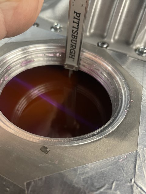

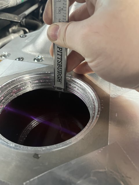

thank you for the information, strike one against me was not having enough coolant in the system.
Fixed that issue, BMR recommends 1/2 inch from lid.
second was me not bleeding from the s/c port
when i say she gurgled and air fizzed out i mean it…
