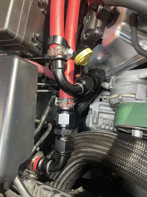

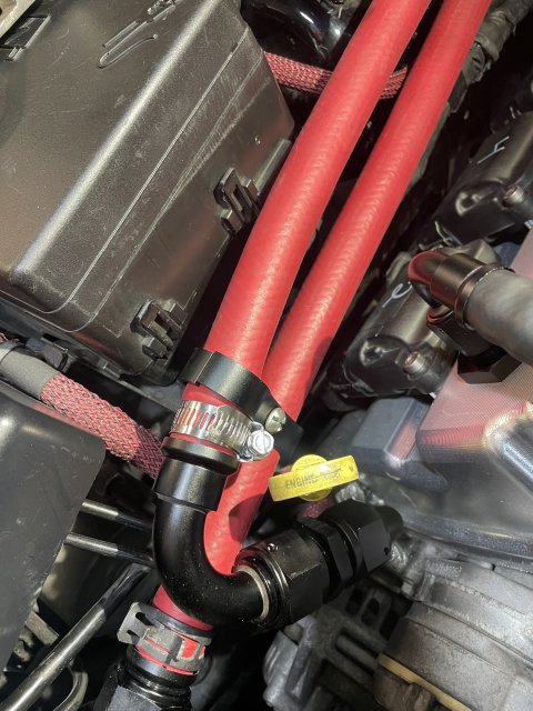

waiting on one brass fitting, might be able to start it tomorrow. Did a test. Can get to coils still no problem. If necess

working with Allpar and IC Chiller on something but thats 🤫

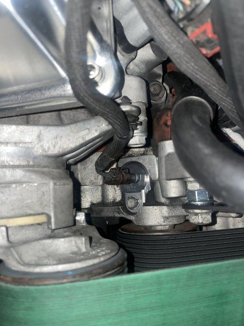

Cam position sensor might be leaking?

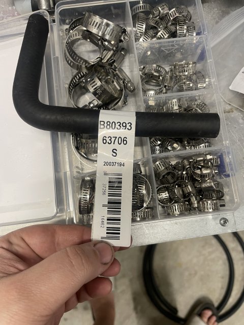

If you need to make an custom elbow this is the one I used 20C17495-AD59-4688-B67F-8073367B205B.jpeg
The IC chiller is doing its thing!
cleaned and replaced View attachment 98229

If you need to make an custom elbow this is the one I used View attachment 98231

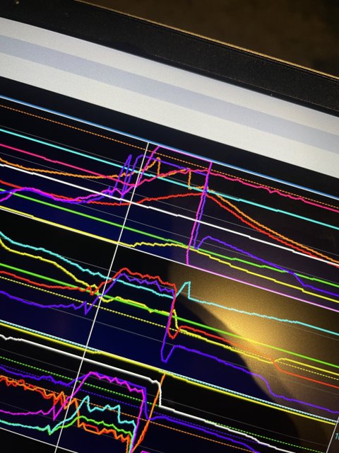

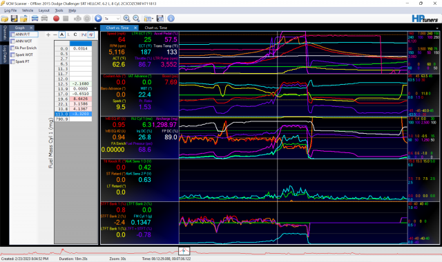

why doesn’t anyone show what the manifold air temps are that’s the only number that matters and pulls timing

Temp was really killing ke on my passes I was reaching 170 manifold air temp at the top end, was pulling 2 degrees of timing
Not a problem broski. Start of pull: 62.6
End of pull: 87.8
Keep in mind air charge temps start to pull timing based on the following values in the tune:
You could move Part Throttle Ref IAT to 999 and it would never pull timing...

Idk 170 is hot man that’s just asking for trouble, I need to get it down but wanted to see the true benefits of the cooler. Heck if they kept em below 140 on the top end would still be well worth it

One of the things I want to make perfectly clear, this is not indicative of sitting in a hot ass staging lane waiting to make a pass. Our superchargers cool also by passive air going through the throttle body. When you sit, you still get a little bit of heat soak but it's temporary. You'll see ACT dip immediately as soon as that throttle rips open but then it will rise. I estimate on a hot ass summer day that it will go from 80 to 130, that still well below the threshold, if you need the math behind that let me know too.
that's a rookie number, i almost blew my shit up last year. pulled 8 degrees
8,451
7,368
Holy crap when it was 60 degrees out? That’s cooking, must be spinning it fast. Was this before the BMR tank?
7,271
18,972
@fumanchu182 how'd you get the "Boost" pid? Maybe it's in there by default and I never noticed.
For reference the Magnuson on my old car would get IATs to around 175°F or so at the end of the 1/4 on a reasonably warm day. I'd say 170°F is warm but not crazy hot. I'd not want to go over that though. On my original Hellcat 2.4L I've seen 168°F in 3,000 DA on the 2.72 pulley.
