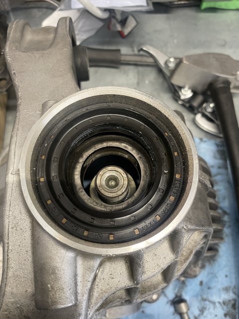

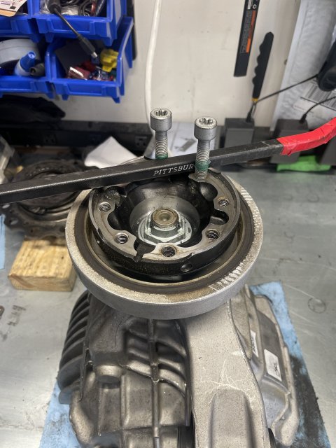

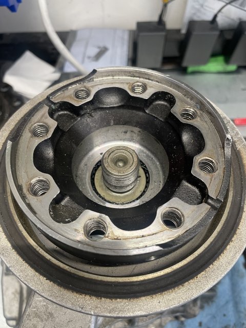

old diff bolts and a pry bar, 32mm impact socket and ugga duggas. IMG_8909.jpeg

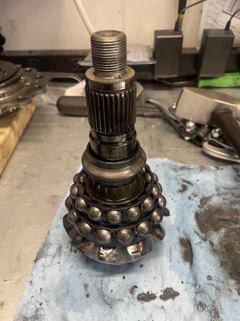

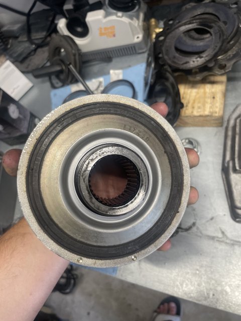

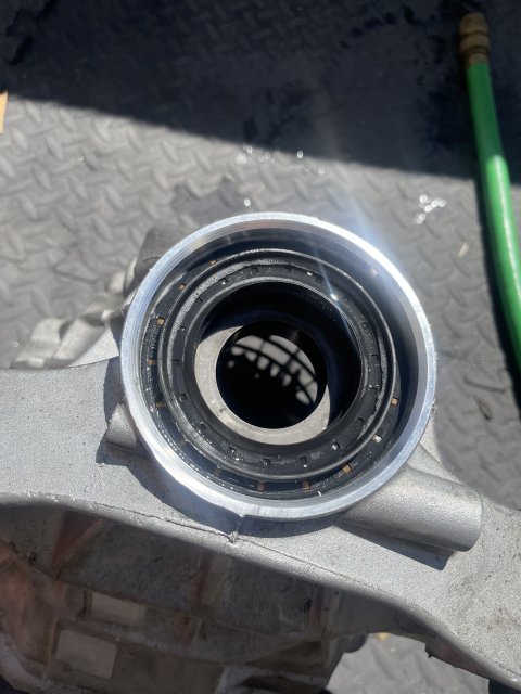

Dirty hoe, simple green and brake clean, high af after 71657589531__9F9D5E94-3863-4C5A-BEE4-2D91D1FDD5D9.jpeg

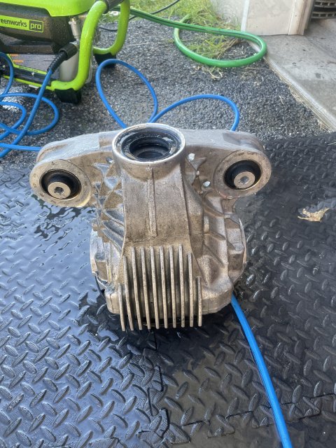

In the kit comes a setup plate, bolts sourced out of the fuck it bucket IMG_8931.jpeg
caution: do not use brake clean on the pinion flange, pressed rubber bushings you cannot replace, pinion was inspected, all bearings good, all machined surfaces good. IMG_8935.jpeg

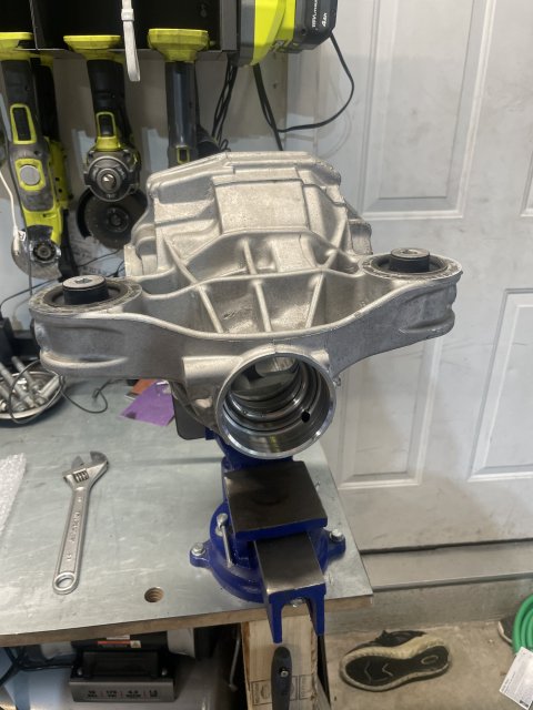

Pinion gears are sharp, need to pull the ring gear but thats a tomorrow me problem, time to go get beer

Thats a hell of a beefy bearing arrangement there on that pinion assy!!!
4,098
10,268
Thread Starter #1,805
It is, pain the balls to clean. However they spin freely now, was having an issue where it was binding before cleaning, think there was a ton metal in there. There are no specs on ZF diffs so its going to be trial and error to get backlash correct. I have numbers from dusterhoff and will confirm on assembly. Need to pickup seals on Monday.
Okay now I see why there’s no aftermarket dang
