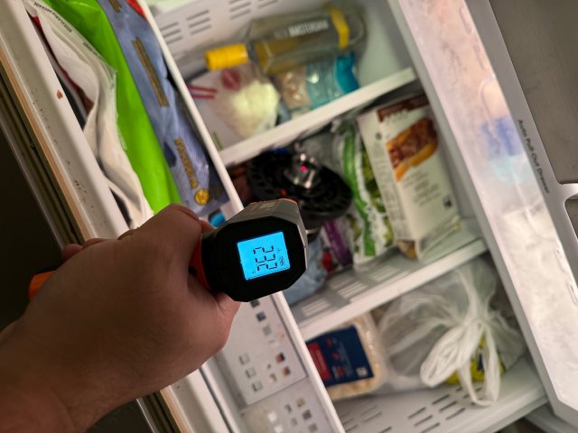

did exactly that, still didnt help

Then again the “bread” truck didn’t work for me for getting pilot bearing out
